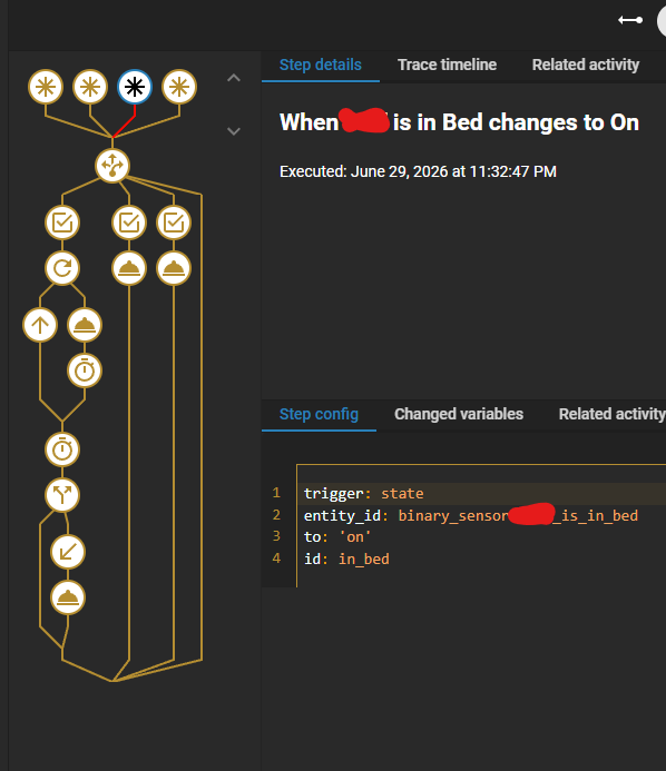

The trace for the automation shows that it was triggered but the actions weren't run.
this shows that it was triggered:

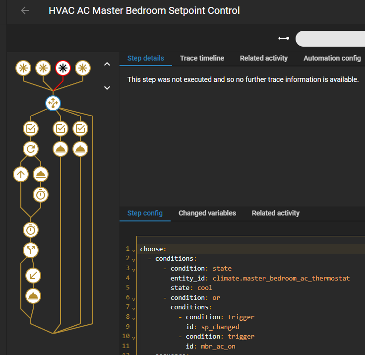

But looking at the choose step it says that the choose step was not executed:
This happened at least once before recently but I thought it was only a fluke.

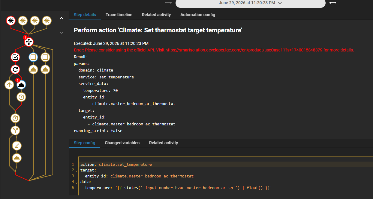

But for additional info the same automation was triggered 12 minutes earlier but produced an error:
I've had that same API error occur a few times as it seems the both the core LG ThinQ integration and the custom SmartThinQ integration API calls are a bit buggy?
I checked the home-assistant.log file about any automation errors during the time periods for both triggers (23:20 and 23:32) but there is nothing at all. It doesn't even mention the API error from the first automation trace. So I'm not sure where that error gets set in the trace timeline.
any idea how a trigger could occur but not actually run the first step in the actions (the choose step)?

I had a long post explaining what I was trying to find out but then I looked at a couple of other previous traces and I realized what was happening...
the automation was performing a repeat loop from a previous trigger and since the default run mode is single it blocked the execution of that run until the first run completed.
the trace just showing a red line to nowhere wasn't as helpful as it could be. I had to look at the trace timeline section and it said why it stopped in there. And it is strange that nothing was reported in the logs. the docs say that a warning will be raised but I didn't see anything at all about any automation in the logs in that timeframe.
