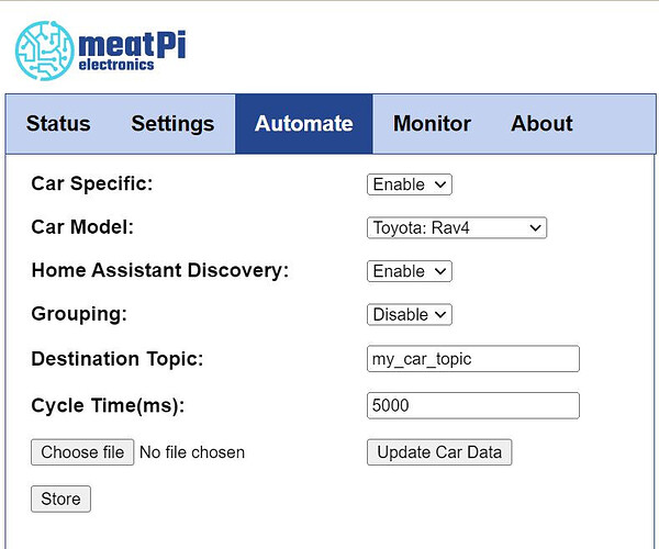

New FW is out: Release v3.21Beta · meatpiHQ/wican-fw · GitHub
Supports Car spezific settings using a json file.

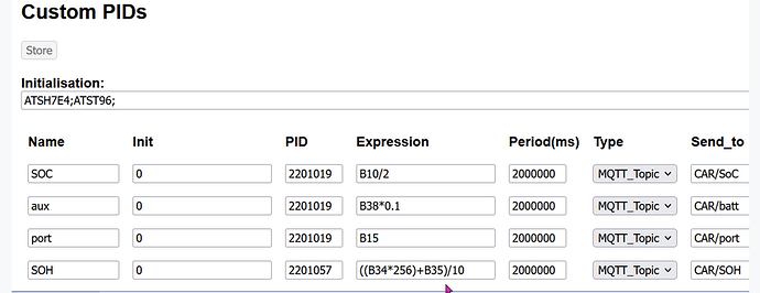

for my Ioniq 5, E-vehicle, i see this equation ((B34<8)+B35)/10
any idea what this “<” do? what does B34 do to 8?
Hi Tung256
I think that is a sort of C syntax for a bit shift. In C the << means shift left, the 8 means 8 positions. In reality that means a divide by 256.
To be honest a multiplcation by 256 would make more sense:-) then it is just a two byte 2 number, with one being the high and the other the low part.
you are right!
this works great now

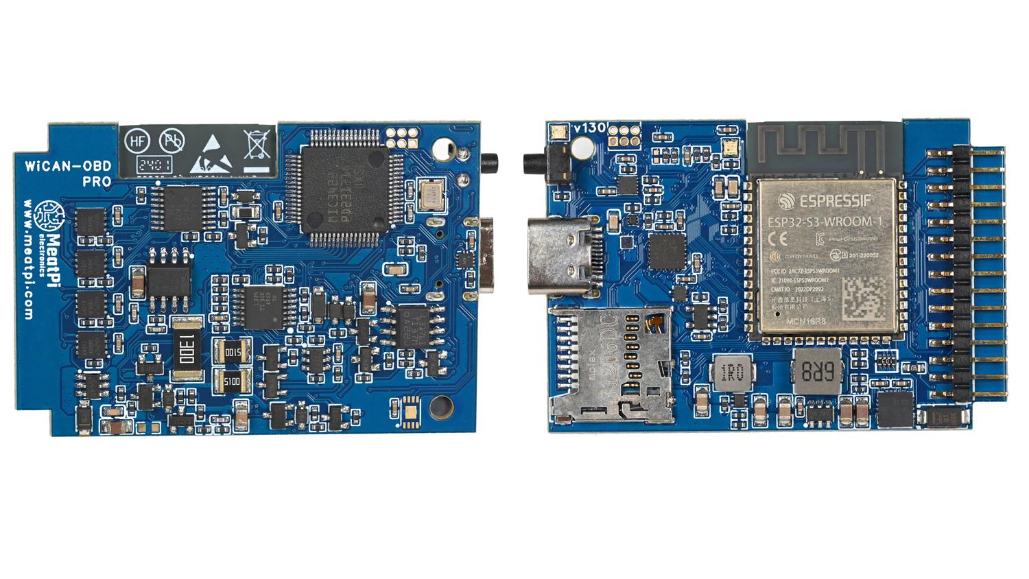

FYI, WiCAN developer @MeatPi has now started a new crowdfunding/crowdsourcing campaign for an updated ”WiCAN Pro” next-generation OBD dongle product that includes an added dedicated CAN bus chip that provides full support for all legislated OBD-II protocols as well as featuring a powered-USB port for hardware addons (including an upcoming ESPNetLink LTE/GPS module for it to allow for real-time location tracking and online data analysis), this one will also have a microSD card slot for data logging:

Over the past couple of months, I have been working on better integration with Home Assistant, making it easier for you to pull data from your vehicles. My goal is to make the process as seamless as possible. With the new wican firmware, users will be able to simply select their car model and the available parameters will be pushed to Home Assistant over MQTT. I’ve also added a Home Assistant MQTT Discovery option, so all available sensors will be automatically created in Home Assistant. Additionally, users can add their own custom PID requests for even more flexibility. Currently, only a few cars are supported, but I expect the list to grow rapidly.
It’s now easier to support more vehicle models by simply adding a JSON file, allowing users to share their vehicle profiles and contribute to the WiCAN firmware by making a pull request. This improvement is thanks to backer Jay O., who suggested and implemented the idea of having a separate JSON file for each vehicle and using GitHub Actions to merge them into a single file. This merged file will be built into the new firmware version or can be directly uploaded to WiCAN.

Hi Tung, I’m not sure about the first “Signed(X)”. The second one, I would guess (again based on C syntax comparison, that it takes the lower 6 bits of the byte, so basically a number between 0 and 32. Does that make sense for the entity you are trying to compute?
