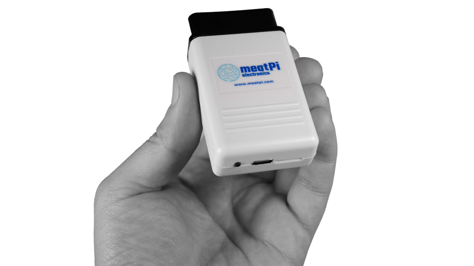

I think that this ESP32-based OBD (On-Board Diagnostics) open-source hardware CAN-bus adapter for reading and controlling vehicle bus of cars or trucks via their ECU (electronic control unit) + a open-source wican firmware combination in this crowdfunding/crowdsourceing campaign on Crowd Supply could make for a very interesting product for monitoring your car or truck if and when the community starts building WiCAN integrations for Home Assistant:
WiCAN” open-source OBD-II Car Diagnostics CAN Bus to WIFi/BLE/USB adapter based on ESP32:

    WiCAN Pro - Advanced OBD scanner for next-generation vehicle diagnostics and Home Assistant integration. Built on the robust ESP32-S3 platform, WiCAN Pro runs the powerful, open-source WiCAN firmware. The inclusion of a USB-C connector for firmware flashing and a microSD card slot for data logging further enhances its functionality.
