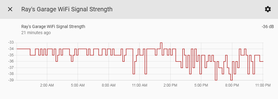

Dang! I just had this idea and thought it was mine!! I started enabling the EspHome.io option:
sensor:
- platform: wifi_signal
name: ${friendly_name} WiFi Signal Strength
update_interval: 600s
… and it works very well to give me an idea of how the signal looks over time:
Anyway, I was thinking it’d be really cool to have a realtime red/green heatmap of all the WiFi enabled devices scattered around my house.
