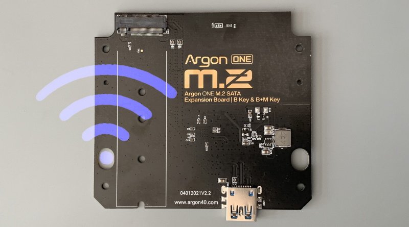

But also any connection to a 2.4GHz wifi don’t work
My router has a 5GHz wifi (with its ssid) and a 2.4GHz with another ssid
The connection to the 5GHz works, but not the 2.4GHz…
I tried with raspberry pi OS on a SD card on this Pi4 and everything works (any connection, inverter included).
What the hell is going on?
The Pi is inside an Argon One case with M2 sata SSD, I read around that this case can make interference with 2.4GHz.
But why this works with Raspberry Pi OS?
Thanks for any help
the Argon One M.2 case is aluminum, can cause Interference with you wifi.
2.4ghz is much weaker that 5ghz
is been discussed here
Argon40 have at least accepted their mistake, fixed it in a revised design and customers contacting customer support will get you a replacement. No debate about if it’s a problem or not, just owning it and doing the right thing. It’s what I’d want to see from any company.
hasOS and PiOS are different network manager, one use wpa_suplicant and the other NMCLI
Yes I see…
I detached the m2 board from argon and connected with a usb3 cable at 30cm distance.
All started working again.
I must investigate why my fan is always on, with 42C…
May be that can cause interference that together with the M2 board can brake my wlan power.
Will this add-on help? For me, the add-on monitors the fan and temperature perfectly.
I found the I2C not available and the argon one addon didn’t work so the fan was all the time @100%
I went through the I2C enabling process and the addon started to work. Now the fan is off (39C) and the 2.4GHz connection work also with the M2 board in its place…
May be the fan was the real problem.
