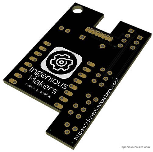

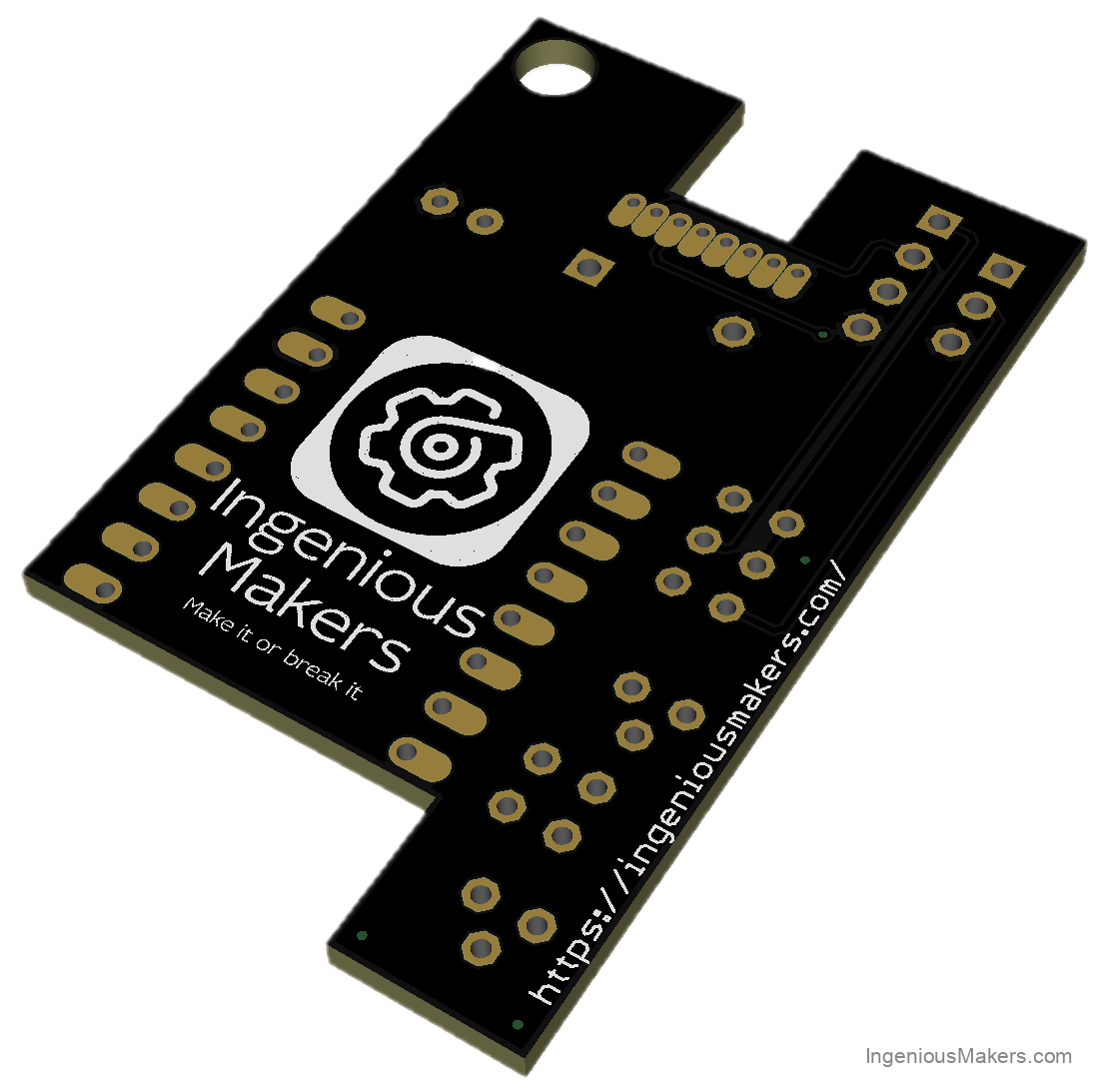

The only thing missing was a drop-in hardware replacement for the original Panasonic DNSK-P11 Wifi-interface so Paul and I started measuring and fiddling around until we came up with this design:
It’s based on the ESP32. No soldering or cutting wires required. Take the original module out, drop the new one in, attach the original cable and off you go :slight_smile:
I still have a few left. There are no commercial intentions, I just needed 2 pcs myself but I had to order 20 pcs assembled and I do not plan to order any further batches.
You can read the full article here. www.espthings.io/p11
