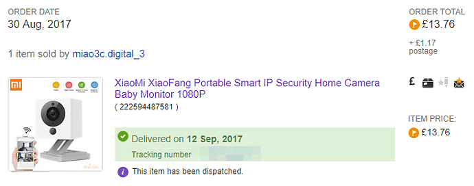

I guess that’s also a possibility… not as easy (cost effective) as running a new spur from an existing socket that’s the other side of wall.
Also I already have xiaofang
