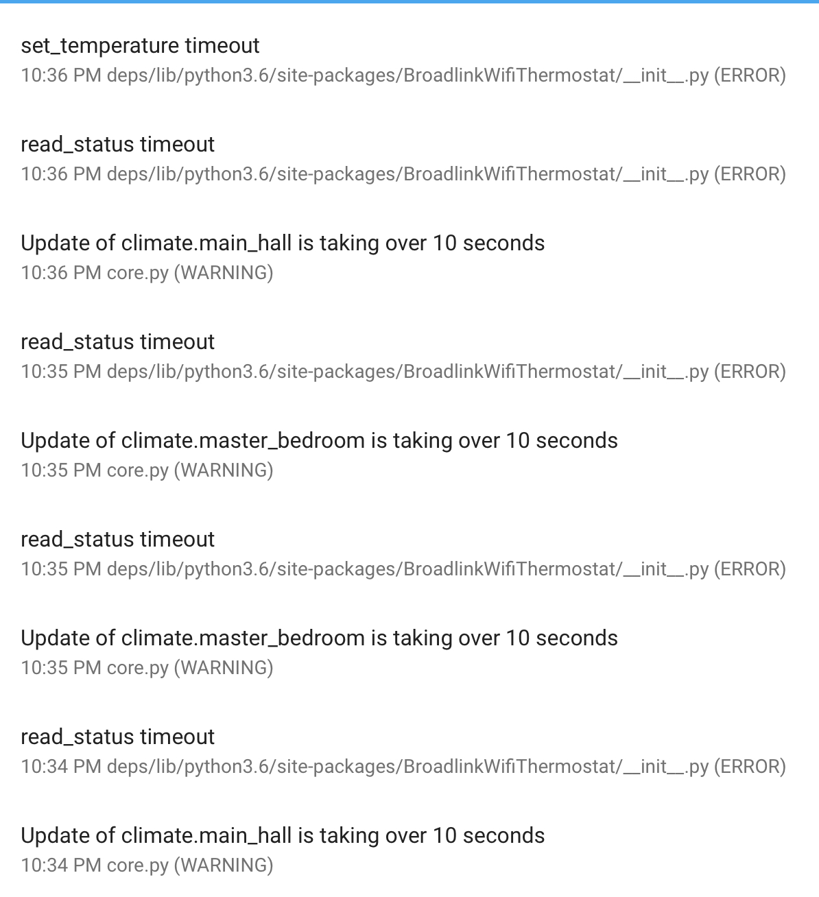

This is what the log shows.
2018-09-25 10:53:46 DEBUG (SyncWorker_12) [BroadlinkWifiThermostat] read_status
2018-09-25 10:53:56 WARNING (MainThread) [homeassistant.helpers.entity] Update of climate.master_bedroom is taking over 10 seconds
2018-09-25 10:53:56 ERROR (SyncWorker_12) [BroadlinkWifiThermostat] read_status timeout
2018-09-25 10:53:56 DEBUG (SyncWorker_5) [BroadlinkWifiThermostat] read_status
2018-09-25 10:54:06 WARNING (MainThread) [homeassistant.helpers.entity] Update of climate.main_hall is taking over 10 seconds
2018-09-25 10:54:06 ERROR (SyncWorker_5) [BroadlinkWifiThermostat] read_status timeout
