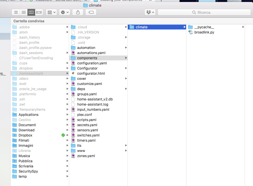

I can not find the config folder. I created it. This is how my / homeassistant looks like this:
However, the error message continues:
platform not found

Confing is your configuration folder, the one which is mounted on your mac.
Just move custom_components (and everything on it) on your root directory, and it should work.
I solved. The same configuration work in Hassio on Raspberry and donât work on Home Assistant installed on my pc OSX. Have you any idea?
