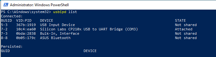

Hello hello,
I had my HA working a raspberry pi and everything was working fine until my pi died on me. I am now trying to achieve exactly what you mentioned above:
on my windows machine, run a HA docker container, that can leverage my sonoff zigbee stick (which was working fine on my pi)
This is what I got to so far:
As you can see, there is no mention of ttyUSBx at all.
I tried all possible combination in my portainer to have the device mapped (/dev/ttyUSB0, /dev/bus/usb/001/004, no mapping) and I still cannot get it to work. Any idea?
Did you manage to find a way to solve this? I’m having the same problem; shows up as attached with ‘usbipd list’ and shows up when running ‘lsusb’, but there isn’t any mapping for /dev/ttyUSBx.
My docker-desktop wsl did NOT seem to support attaching the dongle directly. I got to the point where I could see the device listed when I ran lsusb from the Exec console for the home-assistant container - but it would not list it as a “ttl” device - not only that, but ls /dev/serial/by-id/ would return nothing.
However, I could see the device in Powershell via usbipd list
I was able to get around the issue by creating a second wsl distribution in Powershell.
wsl --install -d Ubuntu
… and attaching my device to it using the bus-id from above
usbipd attach --wsl Ubuntu --busid 7-2
Finally, I had a wsl environment with a working /dev/serial/by-id/
From there, I just needed to modify my docker-compose yaml to include the device mapping -essentially mapping that Linux-friendly device to our home-assistant container.
    devices:
      - "/dev/serial/by-id/usb-Itead_Sonoff_Zigbee_3.0_USB_Dongle_Plus_V2_a2a2c006b74bef11851abaa079f42d1b-if00-port0:/dev/ttyUSB0"
And after all of that, I restarted my homeassistant container and the Zigbee dongle showed up right away under Settings → Integrations. :grin:
