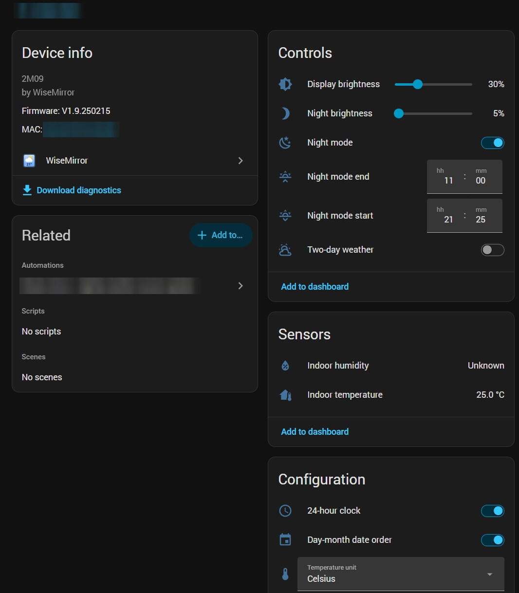

I have an Alasta smart bathroom mirror with a small weather-station display (clock, weather, indoor temperature and humidity). It’s controlled with the WiseMirror app, which is also used by other brands like BYECOLD and GS Mirror. I wanted it in Home Assistant, so I reverse-engineered the protocol and built a custom integration.
It’s fully local: no cloud and no account. HA talks to the mirror over UDP on your LAN.
What you get
  • Automatic discovery, or add the mirror by IP
  • Indoor temperature and humidity sensors
  • Display brightness (0–100, including levels dimmer than the app allows) and night mode with schedule
  • Clock format, date order, temperature unit, two-day forecast, weather source
  • Weather location that can follow your HA home location
  • Connectivity sensor, and automatic recovery if the mirror’s IP changes
