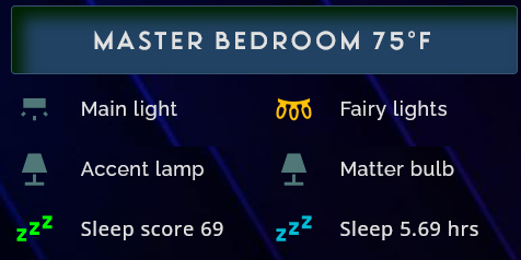

Just a quick note here - I just discovered this integration and got my sleep mat data added to a custom button card dashboard I use. Here’s a photo of the sleep score and total sleep data.
And the code snippet used to add all 3 sleep durations because it doesn’t seem to have a total sleep value returned to HA.

Maybe this will help someone else… hope so!
I need some help from someone smarter than me :slight_smile:
Does anyone know how to get the integer to display as a proper time? For example: 5.5 should display at 5:30 instead of the integer. I’m sure it’s something simple but I’m stumped.
