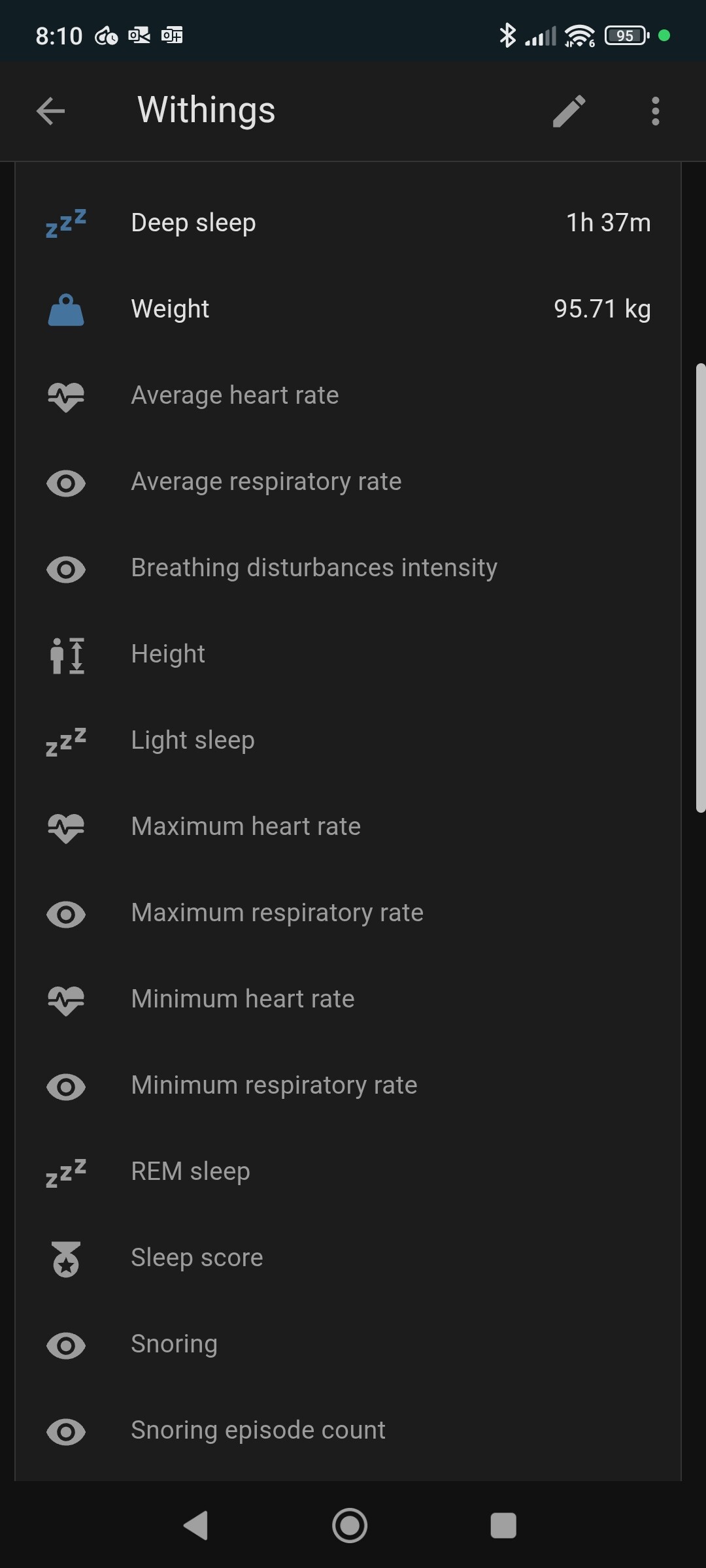

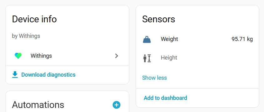

I just got my Withings Sleep Analyzer - set it up (not used it yet, but it has calibrated)
I added the Withings integration to Home assistant and the only items it’s showing are my weight (and height, disabled)
I don’t see any way to add the Sleep Analyzer itself - am I missing something?
After a night’s use the integration has populated with a lot more sensors I can use
But I don’t get an in bed sensor
(There are a couple more I couldn’t fit in the screenshot)
Do I need to take a manual action somewhere to add the in bed sensor?
