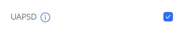

Checked UAPSD

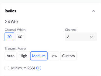

Lastly I went through all of my UniFi Access Points and looked at the Transmit Power. Based on my original site survey I needed a few of them to be on High to get good coverage. I changed each one to a maximum of Medium.
The access points were already configured to not overlap too much the Channel from one to another based on my site survey.
