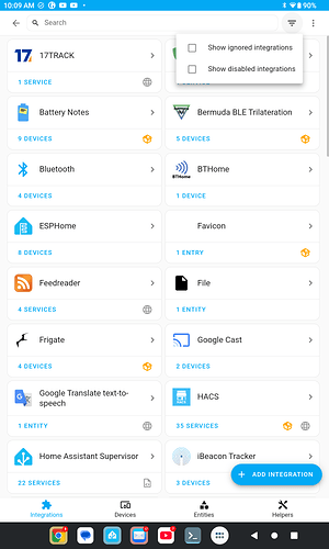

Make sure you didn’t accidentally ignore or disable it first.
Ignored
No ignored integrations
Disabled
No disabled integrations
