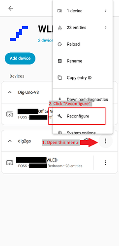

After fighting with my Home Assistant WLED automations for a few weeks, I think I finally got it to work right.
TLDR: If you change any of the settings in LED Preferences in WLED, then you often must go to the WLED integration page in Home Assistant and click “Reconfigure” before HA can control it correctly.
It seems that many of these issues happen because changing the Auto-calculate W channel from RGB mode in WLED changes what type of light Home Assistant thinks the device is (RGB vs RGBW, etc.).
  1. When Auto-calculate White in WLED is set to Accurate or Brighter, Home Assistant will see it as an RGB light, and WLED will handle calculating the white channel.
  2. When Auto-calculate White in WLED is set to None, Home Assistant will see it as an RGBW light (or RGBWW if that is the type you have).
  3. When Auto-calculate White in WLED is set to Dual, the behavior in Home Assistant seems to be inconsistent. This mode requires more testing.

Again, if you want to try any of this out, remember to Reconfigure the WLED device in Home Assistant any time you make a change to the LED Preferences in WLED
