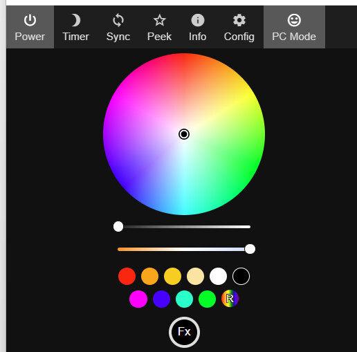

However, its really odd that the center of your colour wheel is actually black! I’ve never seen that before, that should be white.
Interesting. Mine is normal, running v0.14.0-b4 “Hoshi”
colorwheel
Given that the center of your colour wheel is black, and if you think about RGB values like coordinates, you’re telling HA to set the LEDs to the colour at ‘position’ 255,255,255, which IS black, so its doing what its told.
The real question is how on earth you’ve ended up with a colour wheel like that.

If I go into the WLED interface it is white if I click the white color. It only looks like that after trying to set it via HA. If I have the settting set to None in WLED then 0,0,0,255 or setting the color to white works. It’s just when I have it set to Accurate in WLED that it doesn’t work from HA.
This is what mine normally looks like in the WLED interface. It’s just when I try to set it via HA it shows as black in the middle like my picture.
