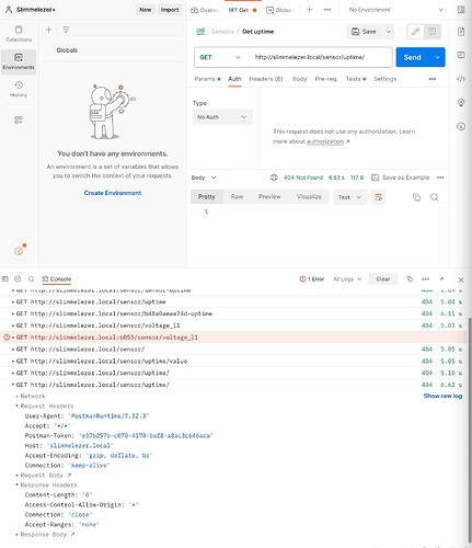

I’ve included a screen of what my postman workspace looks like. AFAIK I’m just sending a simple GET command to an api endpoint for uptime. am I doing it wrong?

I’m trying to talk to the slimmelezer api from my pc using postman. at this point evcc is not in the picture yet.
thanks a lot for your suggestion. using the ip gives me the same result. 404 means page not found, but it is a response from the esphome board. I’m sure that part is fine.

The sensor name is, well, the sensor “name”.
So use, e.g. http://slimmelezer.local/sensor/slimmelezer_uptime
you’re kidding me. that works! thanks a lot :slight_smile: so you just literally copy/paste the sensor name from HA
