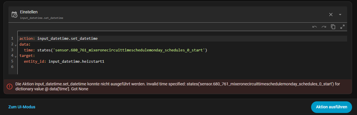

I created a helper called “input_datetime.heizstart1” and wrote an action based on your example, but unfortunately it doesn’t work.
I couldn’t find any examples of how to transfer the value of a sensor to a datetime helper.

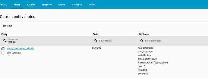

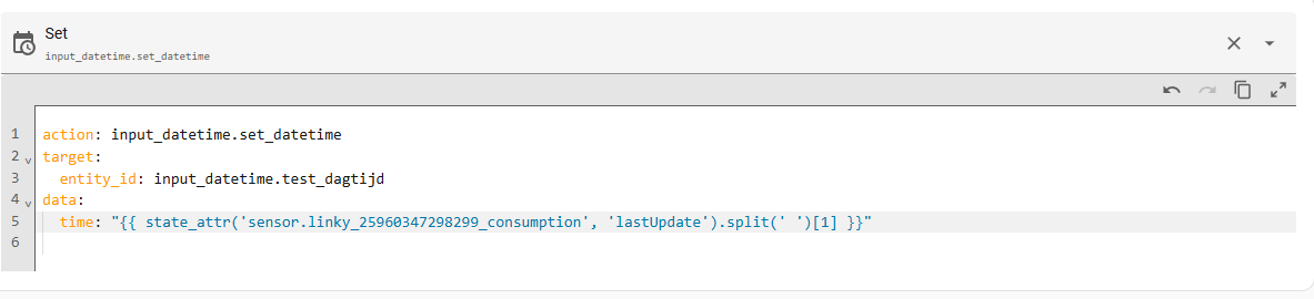

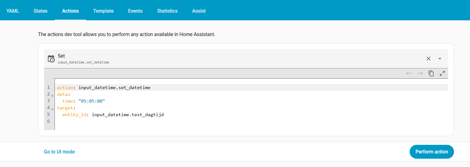

Use the template session and verify what the “states(…)” shows, it needs to be in the proper format … as per the documentation. Try hard-coded date (or time or datetime) first to understand that part before using a template. And a template needs to be in “{{ … }}”
my example (different template)
When I assign a string under time: "01:01:00", it works.

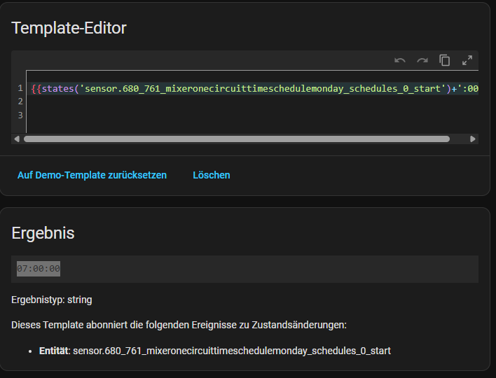

In the template, {{states(‘sensor.680_761_mixeronecircuittimeschedulemonday_schedules_0_start’)+‘:00’}} returns the result “07:00:00”, which is also correct.
But how do I bring these two worlds together?
By putting what you have tested in the template section in the action within (!) double quotes “{{…}}”
Thank you very much for your support, it’s working now.
