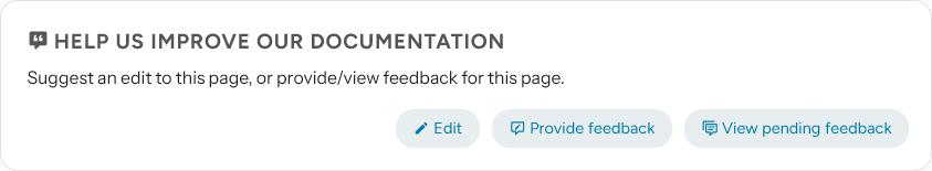

However FYI, at the bottom of every documentation page there are links provided for feedback:
