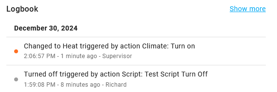

As you can see here, I used two scripts: One script to turn the temp down to 10 degrees, then up to 29 degrees. Nothing in the logbook. It might as well never have happened :smiley:
Then I used the script “Test Script Turn Off” and that one is showing in the logbook.

When I turn the heater back on via Node-Red the log says:
This could have been more specific by showng “Add-on Name” instead of Supervisor.
When I turn it off again via HomeKit, the logbook correctly shows “HomeKit”
