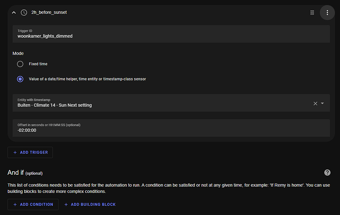

WTH CAN'T we add an offset for the time condition, but we CAN add an offset to the trigger?
When creating an automation, I added a trigger for a specific time, for example Sun Setting, but with an offset of -2 hours for my lights.
However, I can’t do the same thing for the conditions, so when I want to check if the time is 1 hour before sunset, I simply can’t and have to create a helper to achieve the same thing.
It makes things very complicated :wink:
Condition in the automation:
Trigger for the automation:
