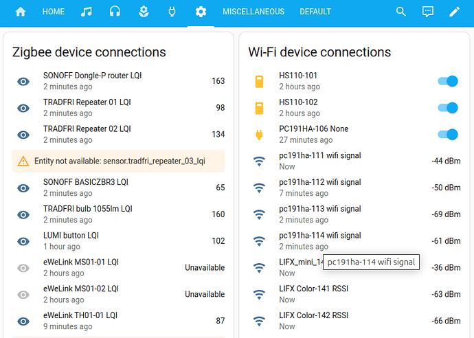

To monitor my wi-fi and zigbee devices I setup a simple lovelace panel showing current RSSI or Wi-fi signal strength and “last updated” as Secondary information … but i don’t look at it often. This required me to add wifi_signal attributes to many ESPHome devices.
