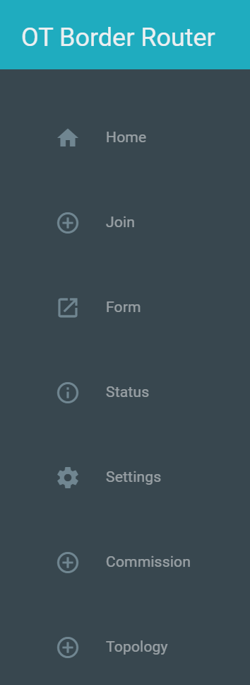

Are you saying that you don’t see this menu on the left-hand side of the web-page (http://192.168.0.30:8080/):
Where you just need to click on “Topology” to see the map?
The home page that I see doesn’t mention Matter at all, just Open Thread Border Router …
I just reloaded again and the menu is showing now. I swear it didn’t earlier as I even went trying to click on anything to get a menu.
