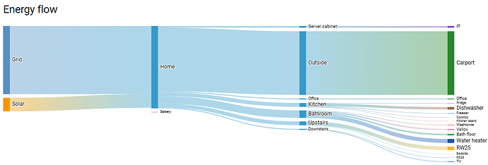

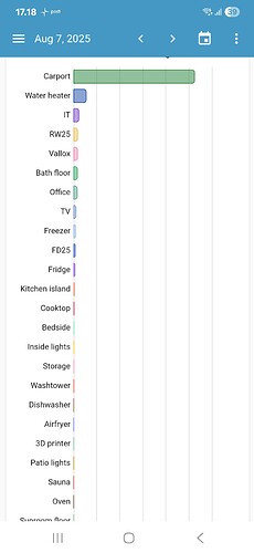

Agreed, this would be a very welcome change. Having EV as part of house loads is not good because it consumes so much more. Makes the graphs useless.
Edit, 30th August, almost the whole month:
Here is another example

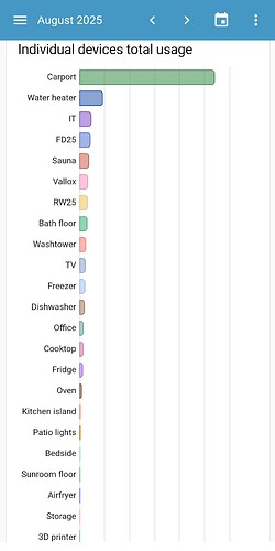

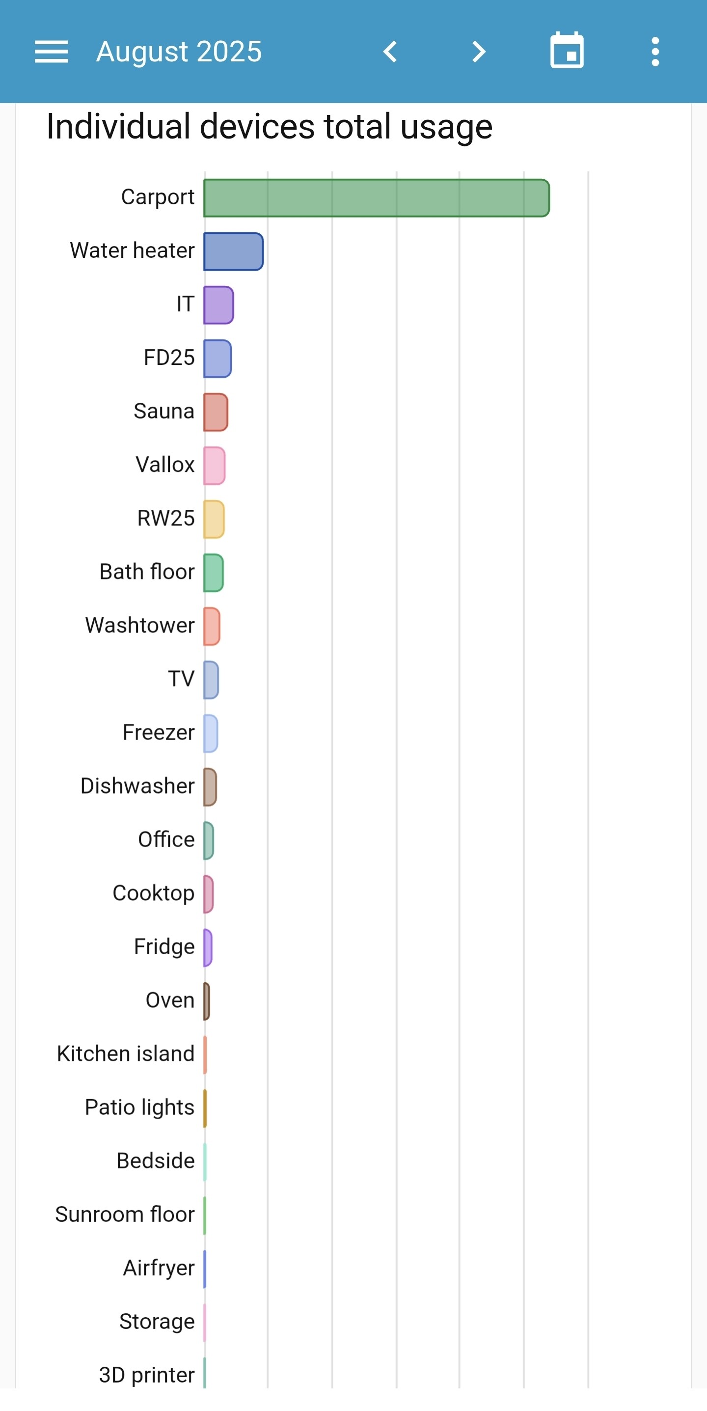

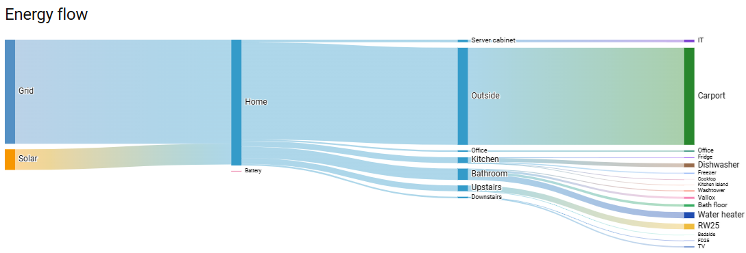

As the situation with HP or EV is bit unsatisfactory, I propose to introduce a second list for individual devices. I guess its’s technically simple and every user could decide what device to add to List A or B. Probably there is no need to give it a definate purpose. Its just that the scale reads differently if big consumers are combined in a seperate list of individual devices. Hope this was understandable?

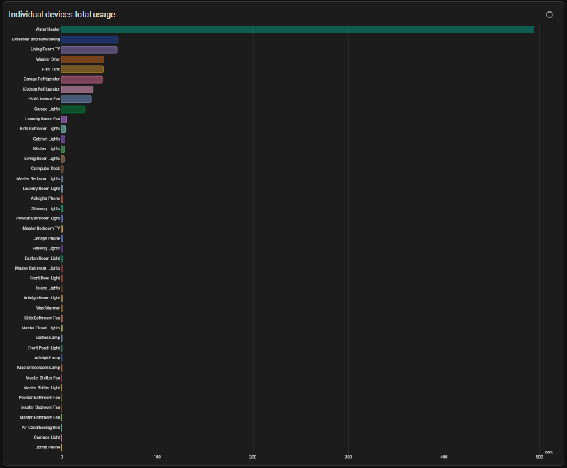

Same issue with my water heater. I don’t know if there is a good way to fix this other than to exclude it from the chart?
