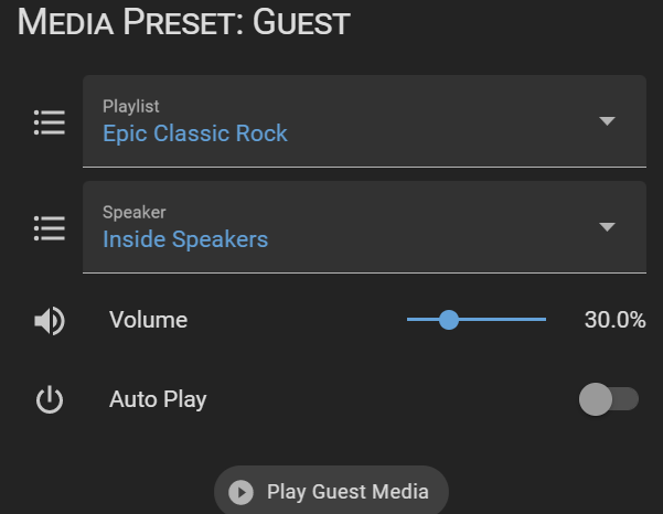

I have guest mode built into my system. My house modes are home, night, away, guest, and vacation.
When the house is in Guest mode it disables all the “personal” automations and there are even separate configurable wake time with alarm clocks, bed time, climate settings, and even automated media presets so the guest can set these without messing with my personal settings.
Guest mode can be activated by either clicking a button on the dashboard (there is a main wall tablet in a central location) or by a guest alarm code being entered into the door lock or guest code being entered into an alarm panel. (They are tied together so if you unlock a door with a code it also automatically disarms the alarm). The house will not go into guest mode if (or my wife) is home and if it is already in guest mode when when arrive back home, guest mode automatically turns off.
When the house is in guest mode, when a door is locked from the outside the house goes into away mode. The only issue I’ve run into is if there are TWO guests at home and one guest leaves locks the door from the outside out of habit the house goes into away mode with the other guest still home. But putting it back into guest mode is done by simply clicking the button on the dashboard and there is also a two minute countdown while the alarm is arming with audio cues so there is ample time to click the button before everything shuts off for away mode. As long as your guests are aware this may come up and how to fix it (one button) it’s not a big deal.
The other thing I do for a longer term guests is create a guest HASS user account (not a person) that can only log in from the local network. Then I have them open a limited guest dashboard in their browser, log with their user account, and then “Add It To The Homescreen”. On android with chrome at least, this looks no different than the app and there is nothing to install. They just delete the shortcut from their phone when they don’t need it any more.
