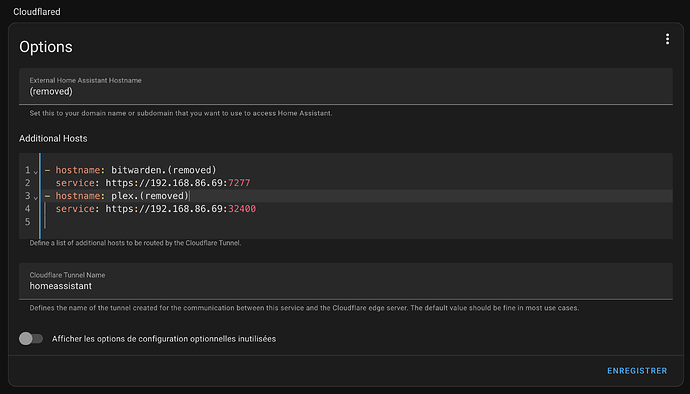

I use Cloudflared and found that changing this part of iframe card address:
http://[MY-HA-URL]:3000/api/hassio_ingress/
to
192.168.1.123/api/hassio_ingress/
(use your own internal ip address)
fixed the 401 problem within the iframes on the android HA app.
using my real world, external URL, did not fix the problem.
