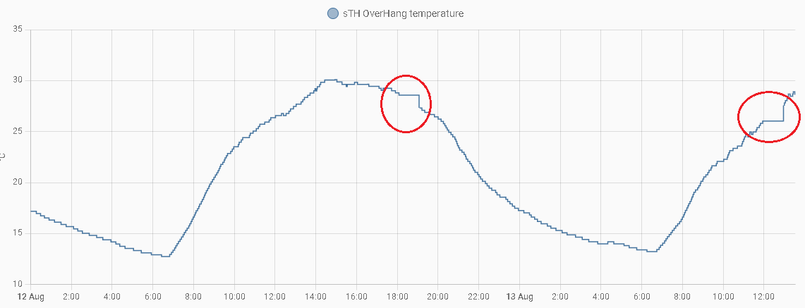

### The problem
August 12, from ~18:04 EEST and August 13, from ~12:00 EEST - n… o new data appears in recorder, MariaDB.
Entities states changing, automation working, but no data in DB (checking by phpMyAdmin, as well see plato on graphs).
MariaDB add-on restart not helping.
August 12 - all become Ok after upgrade 2022.8.2 -> 2022.8.3.
August 13 - working again after upgrade 2022.8.3 -> 2022.8.4.
Probably Core restart can help, will try if happens again.
