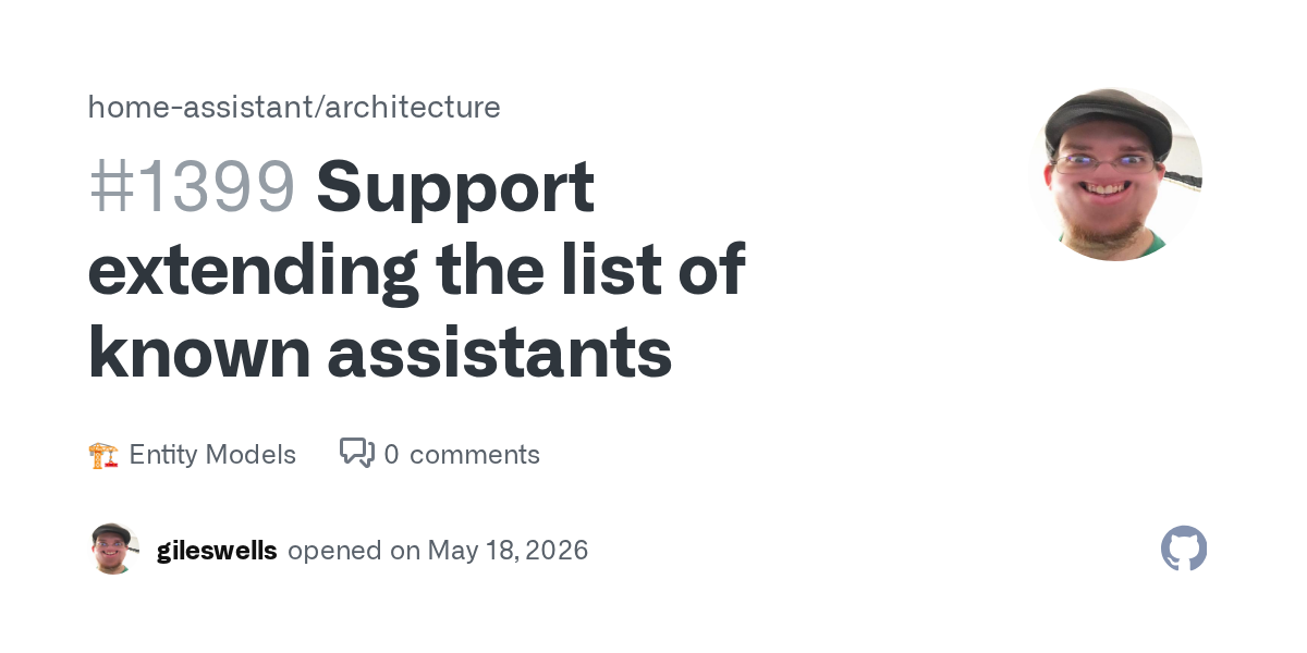

I know this is a decently old post but the issue is still very much valid. I would like to take on the project of integrating HomeKit exposure into same flow that Assist, Amazon Alexa, and Google Assistant have but to do that would require consent / approval from the architecture team as it would require modifications to shared services. I've posted my proposal to their discussion board so that there can be a discussion around this exact topic. If you're able to take a look and provide any feedback or upvotes I would appreciate it.
