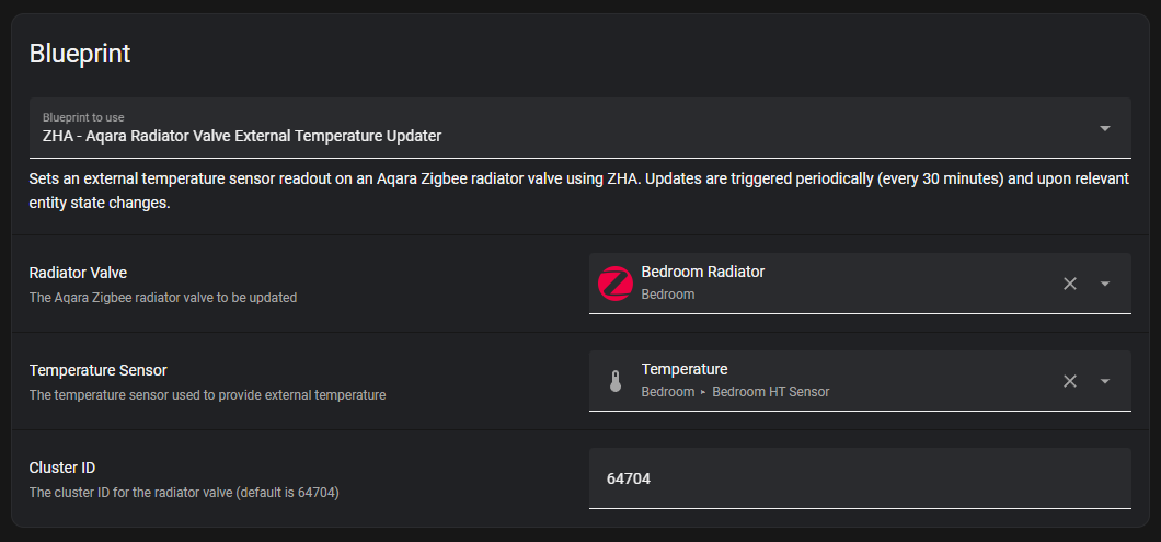

I know necroposting and stuff. But I though I’d share the blueprint I made for the Aqara TRV based on the quirk from the PR, so people don’t have to go on the same journey I had to: Aqara E1 thermostat external temperature sensor by mb1248 · Pull Request #2802 · zigpy/zha-device-handlers · GitHub
This Blueprint takes the following inputs:
  • Takes an Aqara TRV (ZHA)
  • A temperature sensor
  • (Cluster Id)
…and triggers:
  • upon sensor change
    (only when on)
  • every 30 minutes
    (I thought since the thing is battery based, maybe don’t spam it every minute when it’s not actually doing anything)
  • when turning on the heating
…doing the following:
  • set thermostat to use external sensor
  • update value of external sensor based on provided sensor value
There was no good guide on how to setup an automation for this, so I figured it out based on some Github comments and created a blueprint that abstracts almost everything, so you only have to provide the device and a temperature sensor.
