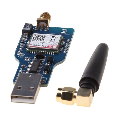

But I mean I want Home Assistant to make the call through the GSM board, using SMS integration or even a new one for calls. But should use the same hardware (GSM board) as the SMS integration.
Just tested it and work great. I’ll start using it for having different alerts for other types of notifications. Thanks for the tip.
The only problem is that it depends on an android app.
I really would like that the GSM board SIM800C could make the call and not be dependent on phone OS.
My GSM board:

I have pretty much the same board. You can program the SIM800 directly to do whatever you want it to do. It supports an extended AT command set. Here’s the official manual. I did this myself for sending me SMS, because I didn’t want to depend on Gammu. Here’s the code. Modifying it to initiate a voice call instead of the SMS is trivial.
That said, I wouldn’t do it if I were you. You can miss the call just as easily as you can miss an SMS. If your phone is on silent for example. You can’t miss the alert from the Emergency Alert app.
