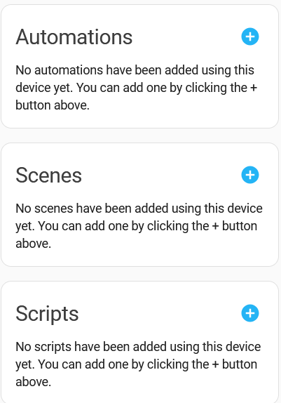

When I press my mobile button it triggers not only the light I set in my automation but another light as well.
I looked into all my automations and my Appdaemon Apps and none is connected to that button+that light.
When looking at the device HA confirms it:
In the log book there is not much about what triggered the On state:
It would be so nice to have something:
  • triggered by Automation “xxx”
  • triggered by device
  • triggered by scene “xxx”
  • triggered by script “xxx”
  • triggered by restart

Logbook already shows what triggered what. Not sure what’s going on in your home but it may be an issue at a level lower than HA.
