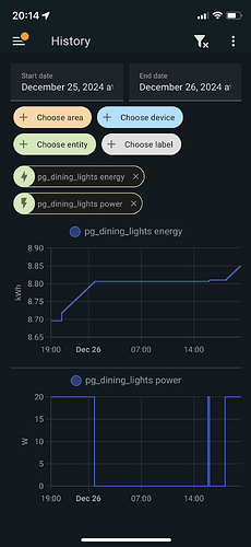

So I think your power metering system must report data immediately, @maxym? It looks like your integration is reporting power data as an entity.

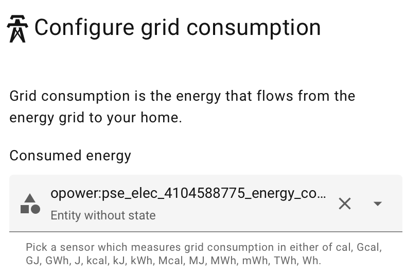

Mine, Opower, doesn’t exactly report an entity. I don’t understand exactly what it’s doing, but I get an option in the energy dash config to add the power consumption, opower:scl_elec_xxxxxxxxxx_energy_consumption. Opower has an aforementioned 48hr delay, but the data appears in the energy dash if I go back a few days.
I have no idea how this works or what it’s called, because it seems to be getting historical data from 48h ago. I wasn’t aware that many other energy consumption integrations were reporting data as an entity.
So my original request was that this weird historical energy data be viewable in the history page, just like the entities shown in @maxym’s screenshot.
Yeah so, again, I don’t really understand how HA is recording/representing energy data. Does the increasing statistic type even apply to energy consumption? Not sure if energy is some sort of special subclass of an entity or something? If I understand correctly, I think there would already have to be some code to “translate” energy data o something the existing history graph system understands.
