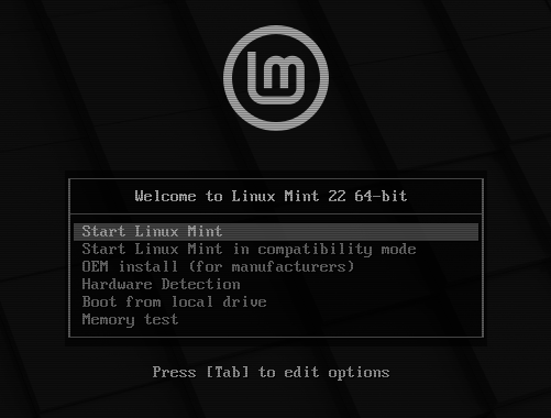

The Ubuntu example (4th photo) is what I have in mind. The second and third photos would be great steps in the right direction as well.
I am envisioning being able to boot a live instance of HAOS and click (or arrow/enter) my way through till the host machine has it installed. When I was a first time user, I used an old laptop so I would not have to spend any money to figure out if Home Assistant was for me. I assume that is a fairly common way that people begin their Home Assistant journey.

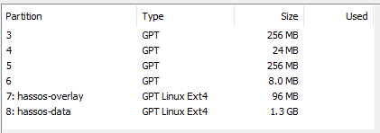

I am under the impression that this should be possible(creating some hybrid LinuxHAOS.iso installer thing(if i succeed itll probably still only run from the usb))
Option A: Without BusyBox (Direct HAOS Boot)
This assumes HAOS can boot directly from its kernel and initrd:
├── boot/
│   ├── grubx64.efi
│   └── grub/
│       └── grub.cfg
├── kernel/
│   ├── 1.hassos-kernel0.img
│   └── 3.hassos-kernel1.img
├── system/
│   ├── 2.hassos-system0.img
│   └── 4.hassos-system1.img
├── data/
│   └── 7.hassos-data.img
└── install.sh
Option B: With BusyBox (Minimal Environment for Installation)
This adds a minimal Linux kernel, initramfs (with BusyBox), and links to HAOS:
├── boot/
│   ├── grubx64.efi
│   └── grub/
│       └── grub.cfg
├── busybox/
│   ├── vmlinuz         # Minimal Linux kernel
│   ├── initrd.img      # Initramfs with BusyBox
├── kernel/
├── system/
├── data/
└── install.sh
