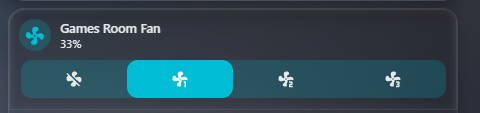

Standard Tile card with custom features:
  - type: tile
    entity: fan.games_room_fan
    name: Games Room Fan
    vertical: false
    features:
      - type: fan-speed
    features_position: bottom
    grid_options:
      columns: 12
      rows: 2
Thanks @sparkydave, this looks great.
Rather odd that the Mushroom fan card doesn’t offer this.
