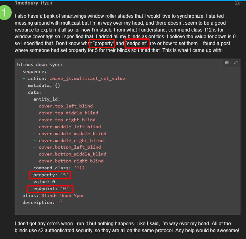

I also have a bank of smartwings window roller shades that I would love to synchronize. I started messing around with multicast but I’m in way over my head, and there doesn’t seem to be a good resource to explain it all so for now I’m stuck. From what I understand, command class 112 is for window coverings so I specified that. I added all my blinds as entities. I believe the value for down is 0 so I specified that. Don’t know what “property” and “endpoint” are or how to set them. I found a post where someone had set property for 5 for their blinds so I tried that. This is what I came up with:
blinds_down_sync:
  sequence:
  - action: zwave_js.multicast_set_value
    metadata: {}
      entity_id:
      - cover.top_left_blind
      - cover.top_middle_blind
      - cover.top_right_blind
      - cover.middle_left_blind
      - cover.middle_middle_blind
      - cover.middle_right_blind
      - cover.bottom_left_blind
      - cover.bottom_middle_blind
      - cover.bottom_right_blind
      command_class: '112'
      property: '5'
      value: 0
      endpoint: '0'
  alias: Blinds Down Sync
  description: ''
I don’t get any errors when I run it but nothing happens. Like I said, I’m way over my head. All of the blinds use s2 authenticated security, so they are all on the same protocol. Any help would be awesome!

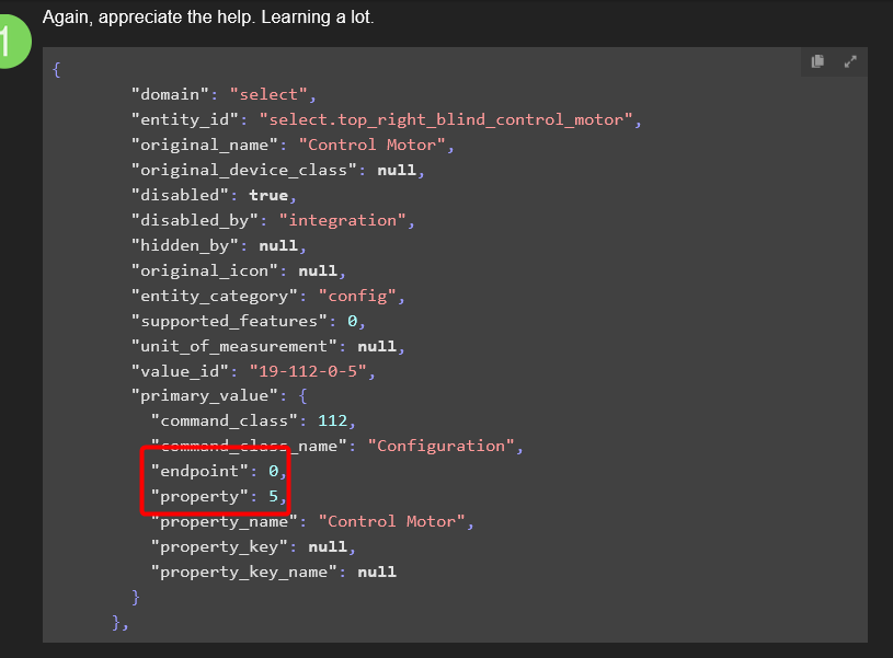

You can only get property and endpoint information from the device in question by looking at it’s diagnostics. Either in ZJS UI, Download Diagnostics from the device (then find it), or if you just know it.
Thanks for the help. I downloaded the diagnostics to see if I could get any further as you suggested. Not exactly sure what I’m looking at but this seems like it might be the correct place to look?
It looks like my original shot in the dark on property and endpoint might have been correct according to this? If so I’m not sure why it isn’t working.
Could it be a different entity that I need to specify? Looking through the diagnostics I’m not sure any others make sense.
Again, appreciate the help. Learning a lot.

Remove the quotes from command_class, endpoint, and property values in your original yaml that you posted.

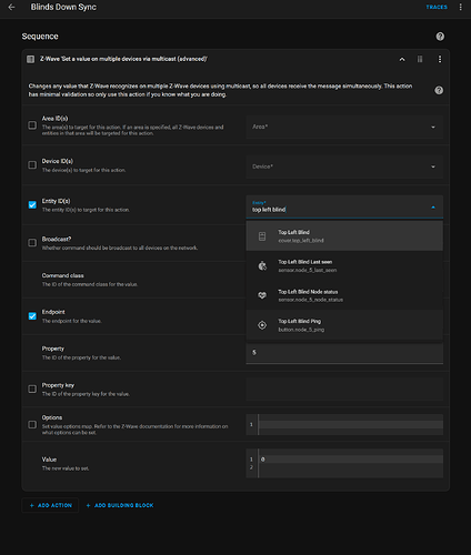

All the service does is run a function against the node with the supplied information. The node is generated from the list of entity ids. So you just need to use a known entity_id that can link to the node.
Here are the entities that autofill in the UI.
So if I’m understanding correctly I can use any of these to link to the node? I have all of the blinds in an area. Could I specify the area instead? Would that make it simpler? Not sure what to try from here.
Thanks
Success! Kind of… The script works but the blinds aren’t as synchronized as I would have hoped. To get them working I changed the command class to multi-level switch (38) from cover (112). I changed property to targetValue instead of 5. Here is the working code:
