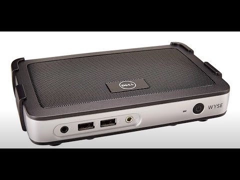

I’m very new to this and think I may have purchased a thin client with no memory. Can anyone tell me from this photo what I would need to do? Or what I would need to buy? Or am I SOL?
That’s not a Dell Wyse 5020. It’s a P25 (or 5030 zero) with only a miniscule amount of onboard storage (512Mb ram and 32Mb - yes that’s Mb - flash). You won’t be able to install HA on that.

Thanks for all the input. This was a newbie error. I thought I ordered the 5020, but actually ordered the 5030. I’m ordering a 5030 now. I’m hoping these specs are sufficient to run HA.
