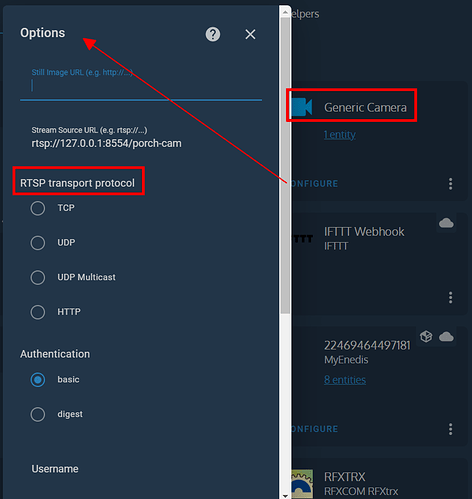

Somethingâs not right (using Generic camera)
Still image :
Unable to load valid image from still image URL (e.g. invalid host, URL or authentication failure). Review log for more info.
Stream source :
Timeout while loading URL

Tried multiple combinations to no avail :
I read posts above but itâs unclear :
What would be the structure of a Wyze cam stream to open in VLC ?..

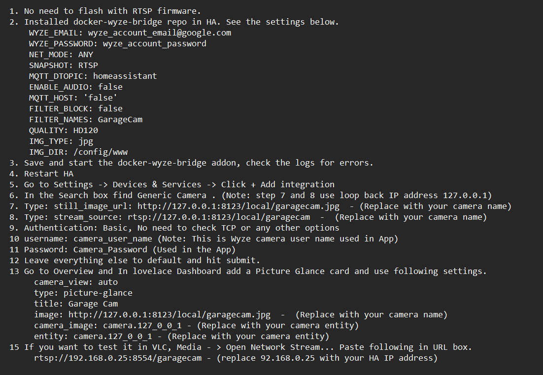

Hi JeromeO,
I was in the same boat as you were. I figured it out and hopefully it can help you too. Here are the steps. I have Wyze Cam V3, factory default firmware 4.36.9.139, Android app ver. v2.31.0 (145)
Hope this helps. (Since the rules did not allow me to post URLs I have pasted image of instuctions)

Thank you for those detailed steps !
Steps 10 and 11 : what are those camera_user_name and camera_password ?
Are they the Wyze credentials ?
If not, where can I find them ?
