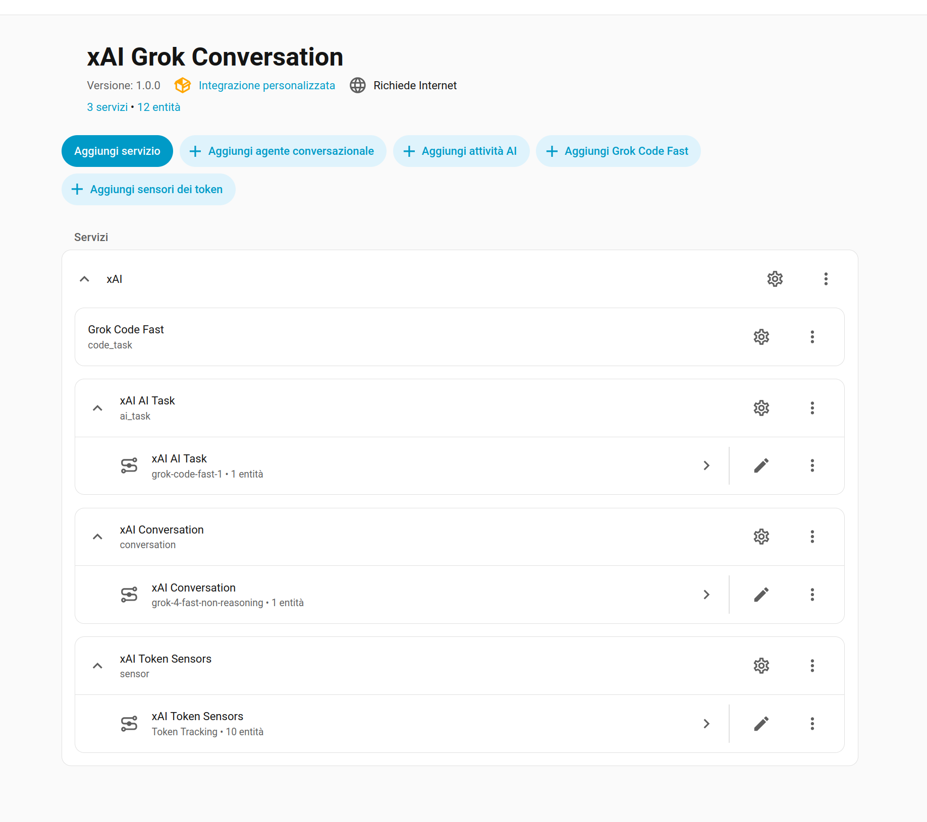

:rocket: Installation
Via HACS (Recommended)
  1. Open HACS in Home Assistant.
  2. Search for “xAI Conversation” and click Download.
  3. Restart Home Assistant.
  4. Go to Settings → Devices & Services → Add Integration → xAI Conversation.
  5. Enter your xAI API key (get one at x.ai).
Install via HACS
Configure Integration

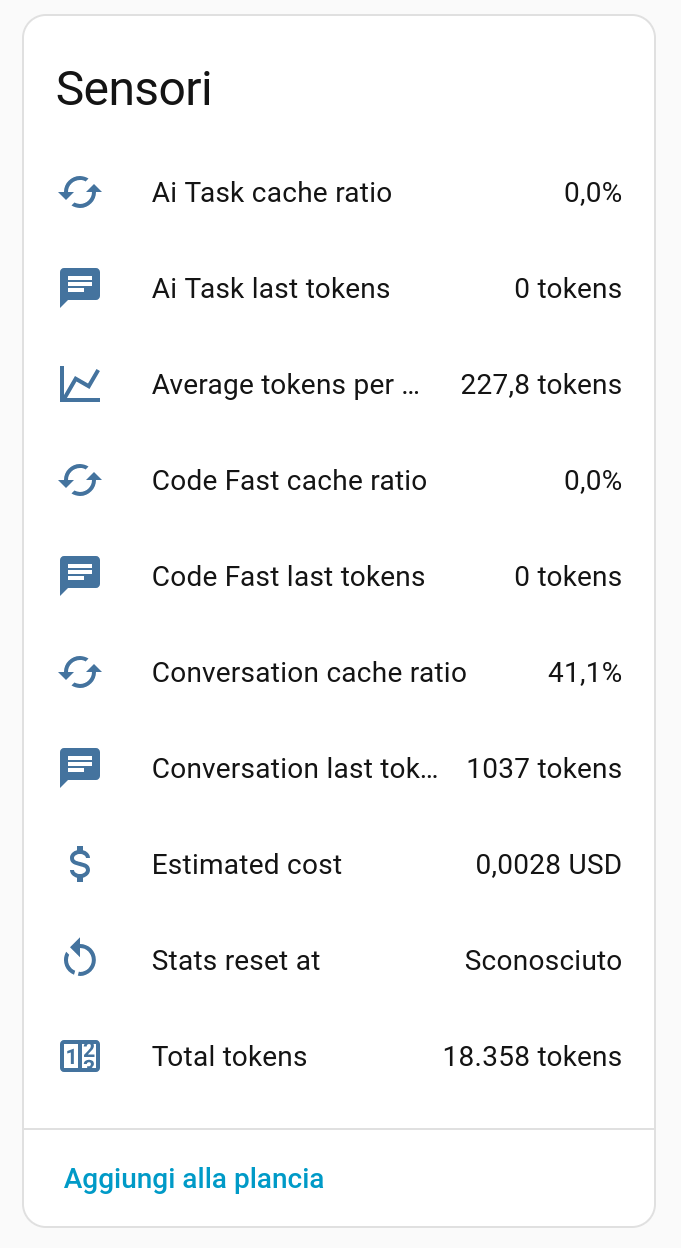

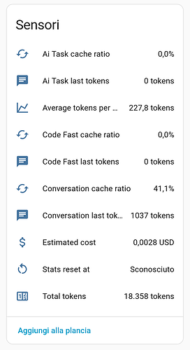

:bar_chart: Real-time Monitoring
Detailed sensors for:
  • model costs
  • token counts
  • cache efficiency
  • xAI Server tool invocations
  • notifications for new model releases.

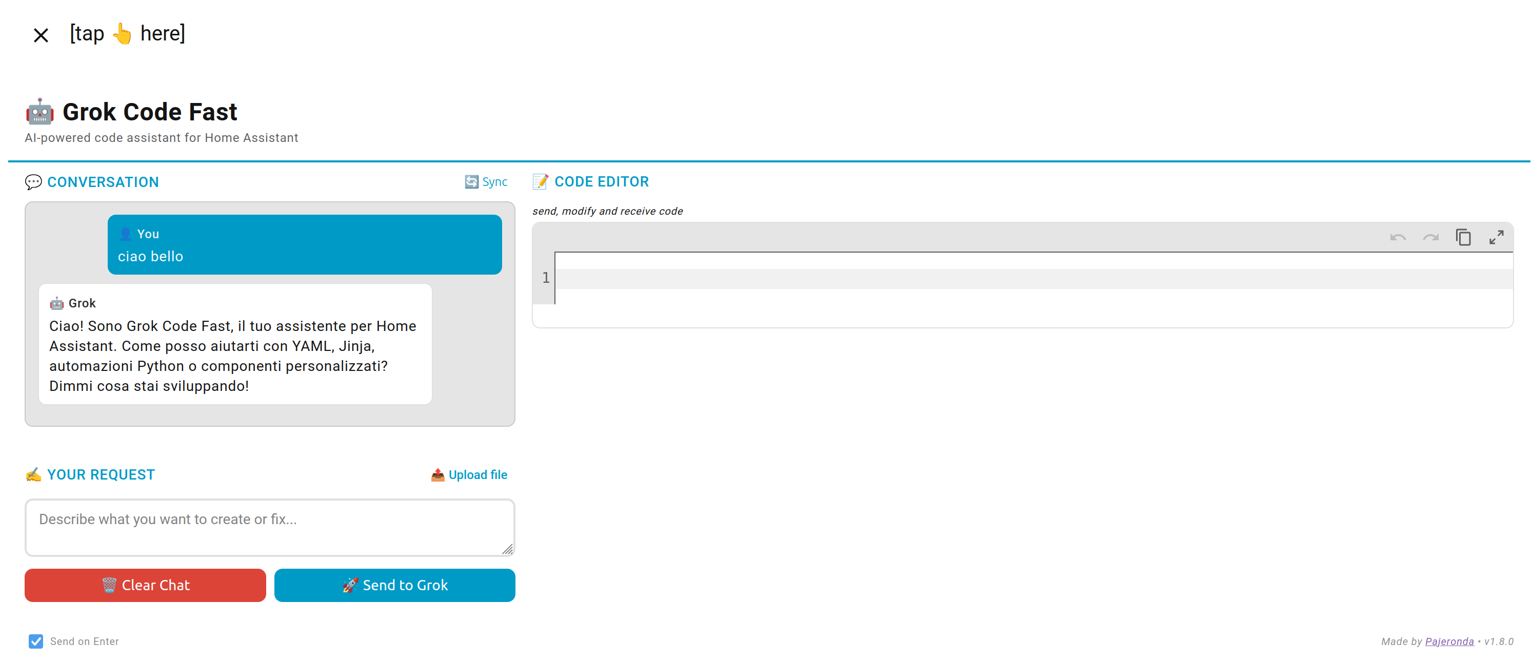

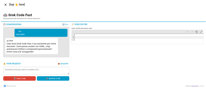

:warning: Deprecation Notice: Grok Code Fast
The Grok Code Fast service and the associated card are now unsupported (available up to release v2.2.1).
We recommend moving to the new and much more powerful AI Code Task integration:
GitHub
Install via your HACS instance.
AI Code Task is an agnostic simple IDE provider in a Lovelace card for code generation. It provides a superior workflow for modifying and generating YAML, Jinja2 templates, Python scripts, and more with an integrated pro editor.
