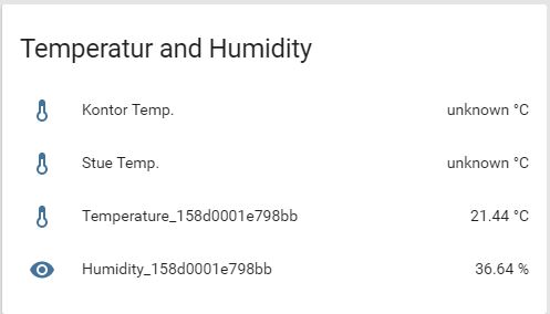

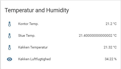

and in my groups.yaml file I added this:(the friendly names dont show up as an entity)
temperatur:
name: Temperatur and Humidity
entities:
- sensor.kontor_temp
- sensor.stue_temp
- sensor.temperature_158d0001e798bb
- sensor.humidity_158d0001e798bb
This is what came out in HA:
How do I change the Xaiomi friendly_name?

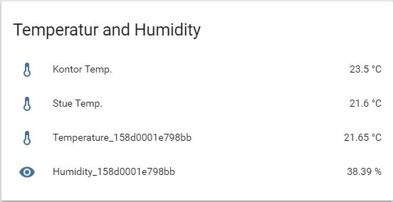

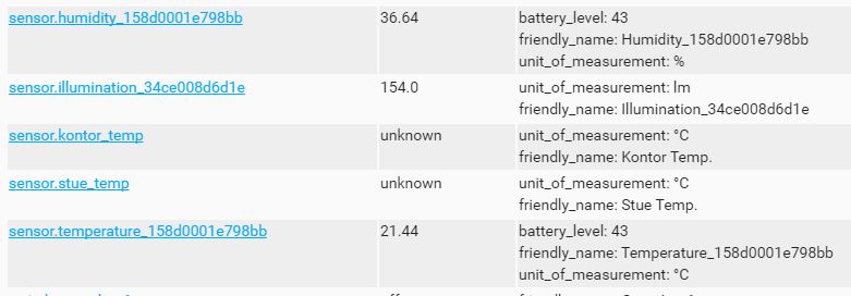

This is the entities list
And this is the output in HA:

kalpcc
(Kenneth Lawrence)
February 1, 2018, 3:01pm
8
Ok Thanks for the help and time!!
I ended up doing it from the HA UI, and it worked
Here is what i did.
deliting the costomize.yaml file i made. HA makes a new one. (I hade to do a chmod 0777 costumize.yaml afte HA was done making the costumizing,
adding the line to configuration.yaml
custumize: !include customize.yaml

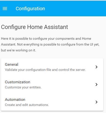

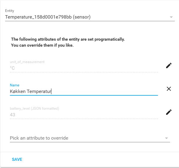

going to the Configuration UI in HA:
making the change and save.
And this is the result:

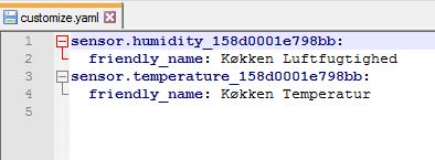

And this is how the HA build costumize.yaml looks like:
