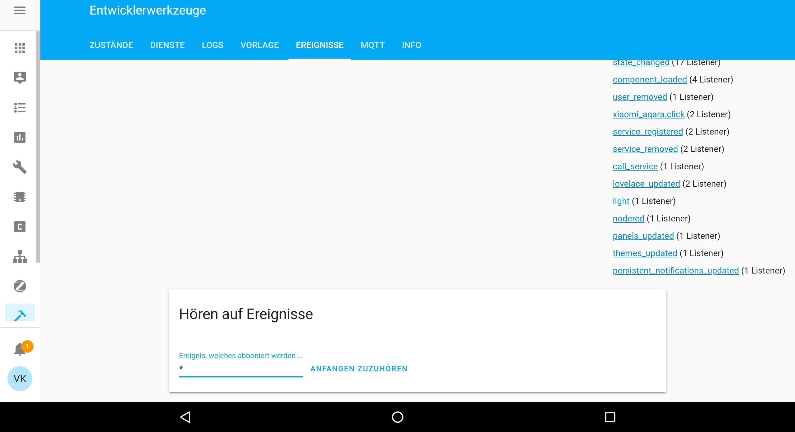

Hello and welcome to the forum. As @dgaust already wrote, go to the “Dev. Tools” afterwards click on “Events”. Scroll down on this page and then enter that here (screenshots). Maybe this will help you…

Thanks for clarification.
The switch doesn’t trigger neither ‘*’ nor ‘xiaomi.aqara_click’ events.
xiaomi.aqara_click events are also not listed in the column for available events (like it is in your screenshot).

Did you try listening for all events by entering * in the listening box? The event_type doesn’t need to be in the list in the event tab. I have for example deconz_event, which is also not showing up in the events list.
