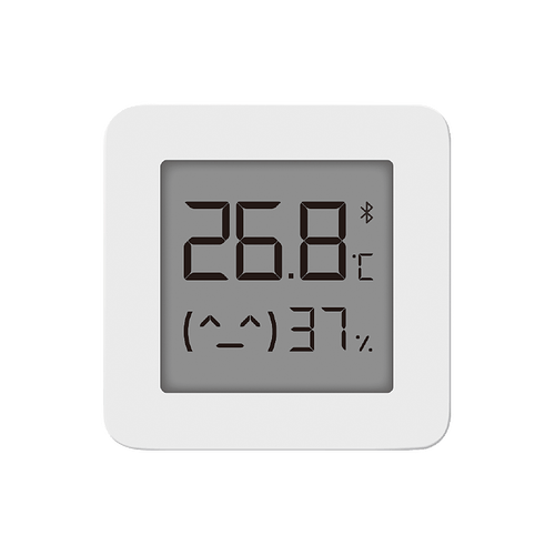

Noob question. What’s “ATC” mean?
I meant this type of temperature-humidity-sensors:
