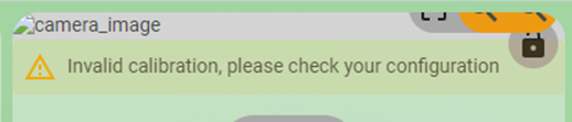

Hi everyone
I have this problem, where the camera entity wont load the map. It says invalid calibration, please check your configuration - but the image on my ha instance is showing the correct map and even updating?
I have a roborock s7 maxv without the dock station.

password: !secret xiaomi_cloud_password
draw: ["all"]
attributes:
- calibration_points
store_map_raw: true
scan_interval: 600
Logs (unable to retrieve was right when I rebooted the vacuum - for 10th time

Is the map available in Xiaomi Home?

If you get failed to retrieve the map from Vacuum, are you able to see the map in the Xiaomi application? this is what I normally see as the issue. The Xiaomi app doesn´t load the map either at that time.
Ijai vacuums are not supported at this moment:
yes correct, I have checked the supported devices. I just asked in case someone somehow managed to do it. If you need help on testing/debugging I can help. Thank you
