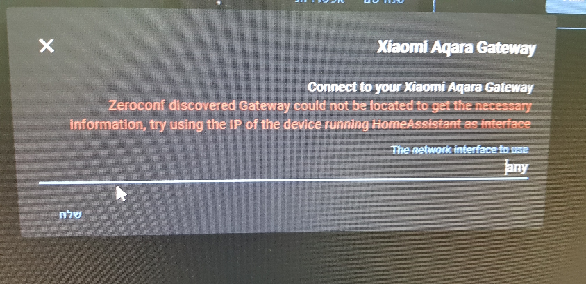

i tryed both of them, and still getting the zeroconf message.

hi i already tryied it and remark all of the old one at the YAMl , reboot and got the same problem.
the ha discover 2 integration :
1 -the xiaomi gw , with 32 api token , and it succeded to configure only the temp sensonr.
2- the aqara gateway which gives me this error , without getting to the api stage.

So more details from me. The first step was to configure each of my three v2 gateways with the Xiaomi Miio component under integration. All three gateways were listed, and each accepted the API token. After that there was just one instance that listed all three gateways hubs, and all temperature sensors attached to those hubs were found, but as noted by others above, NOT switches and other components. Then I went to the three Xiaomi Aqara Gateway components, clicked configure, and submitted with ANY as the network interface.
For my first 2 hubs, it successfully found them and prompted for the key. After entering the key, the other devices were then found. My only outstanding issue is that that last step - searching for the network interface did NOT work for the 3rd hub. I checked to make sure it had a permanent IP address (it has) but still no luck. The only thing that is different about this hub, is that is connected to a Unifi AP that has a wireless uplink to another AP. All the others are connected to an AP that has a wired connection to the router.
So I have 2 hubs connected and all devices disovered and configured, and a 3rd hub only partially discovered, and the temperature sensors for that hub found, but the Gateway setup isn’t working. I guess that’s about 85% there. Any other suggestions to get that third gateway/hub discovered?
