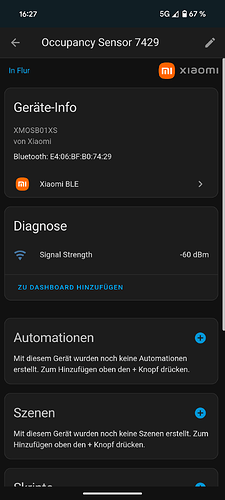

Hey Guys,
i have some struggle to make this sensor works.
It was auto detected and successfully added to Xiaomi BLE. And that’s all. As you can see, i only have the diagnostic: “Signal strength”.
I was not asked for an bindkey.
What i am missing?
HA Version: Core 2025.3.3
Follow these steps and you will be oké.
Thanks for your fast answer. Just for me, Region Chinese mainland is not available. So Chinese is still the same?
If you don’t have the option “Chineese Mainland” (I had) then try Chineese, it might work.
Wow… im not notice that the sensor needs an update. With Region “China” (german) it works. I was asked about the BLE Key. Now i have to wait, if i read this forum correctly, right?
If all went oké the entities should enter over time, just have some patience.

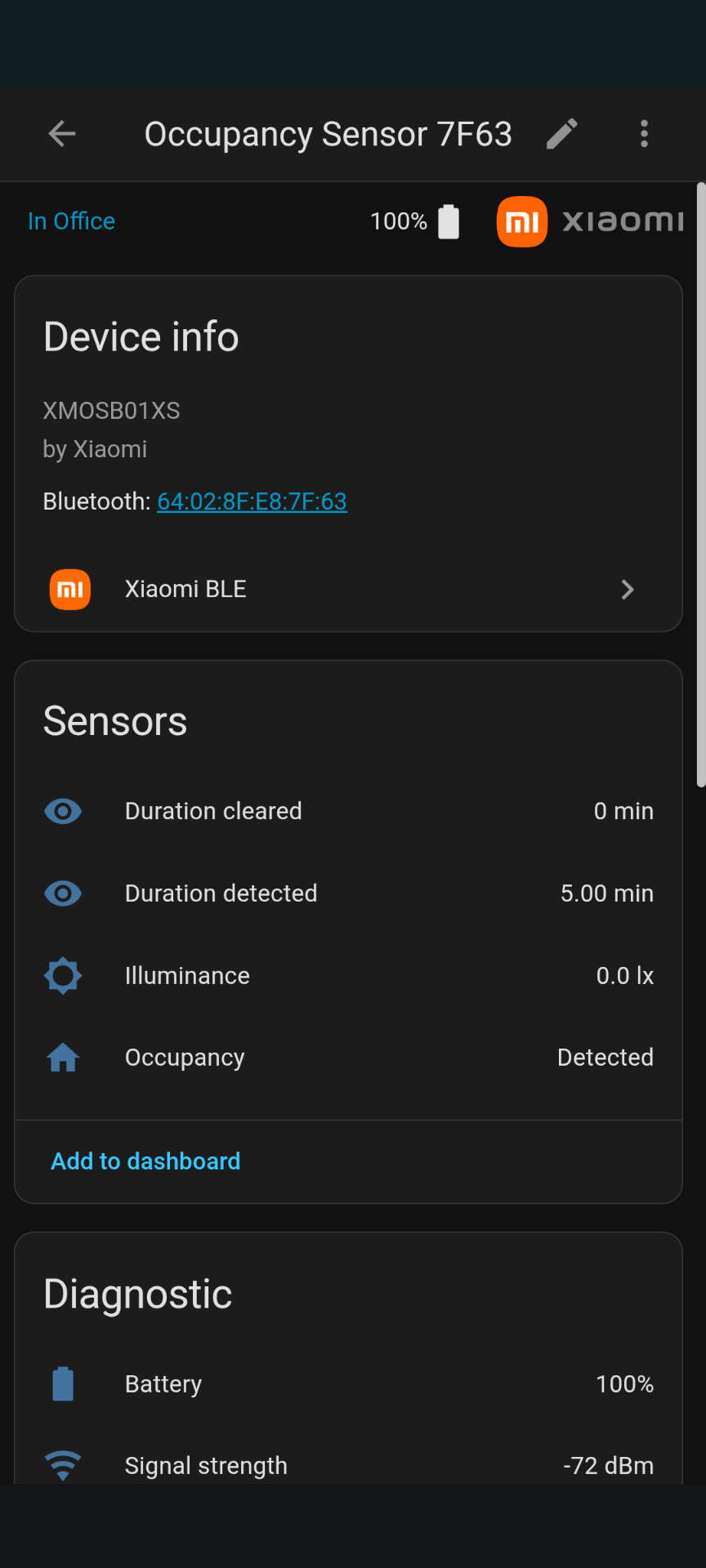

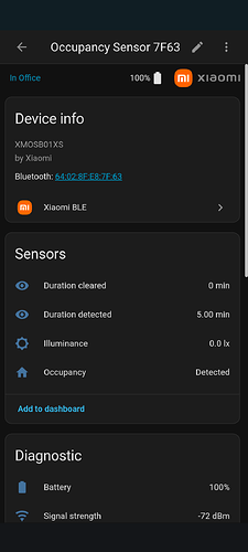

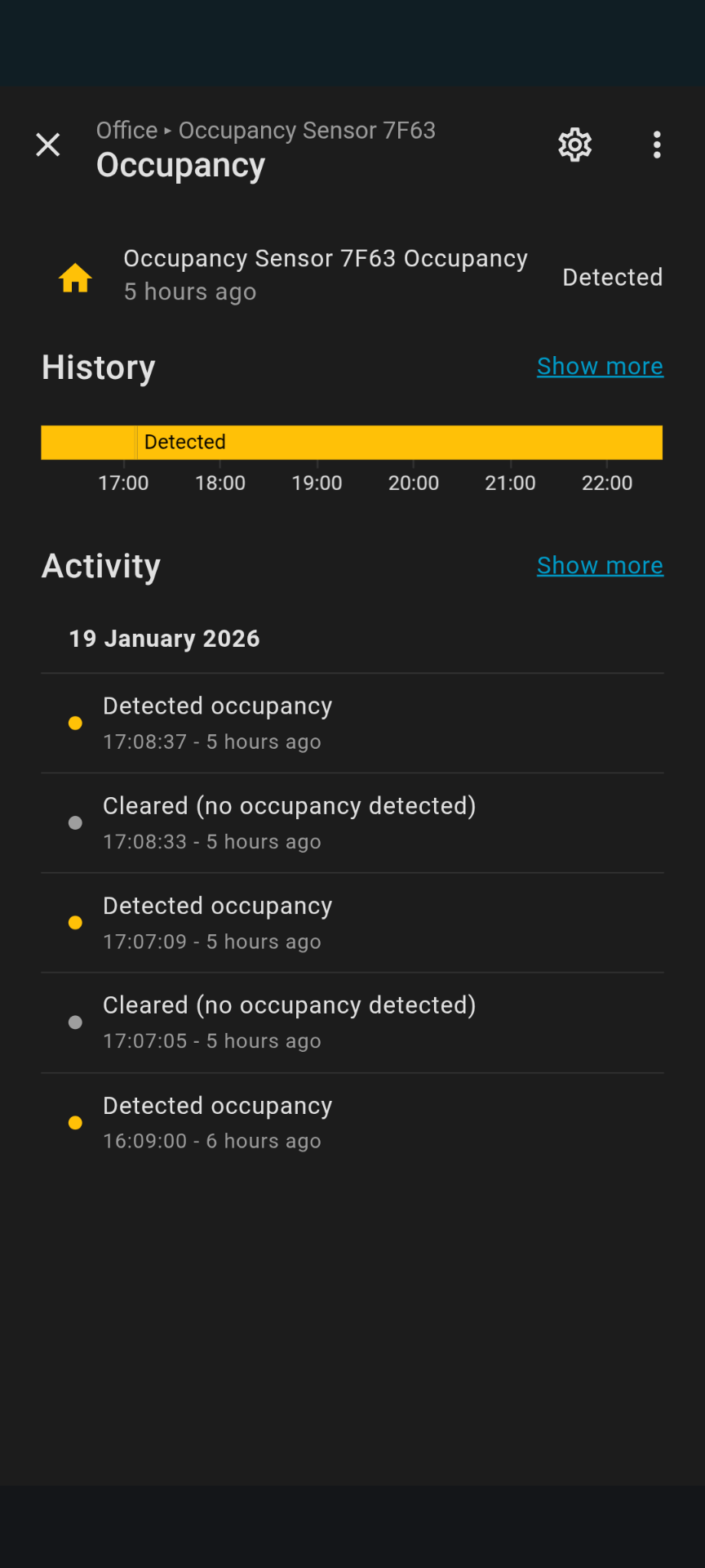

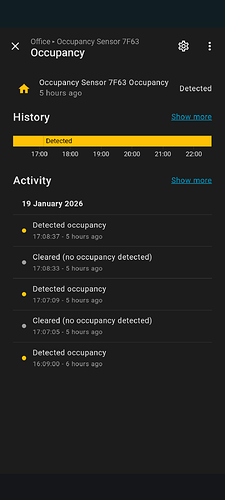

Hi, Before I initiated a return for a faulty sensor please can I get a Sanity check. I’ve added the Xiaomi BLE integration, added the sensor to the Xiaomi app, it pairs fine, detects in HA and then add the BLE key and all seems fine.
The luminescence seems to work fine as does signal strength with both updating regularly and the luminescence changing correctly to the conditions within a second or so.
However despite turning on Geek Mode which detects no interference unless I walk in the room when it then does detect me correctly just to check the detection vaguely works, the sensor immediately goes to Detected and then counts up to 5 minutes since detection and doesn’t change for hours. If I reset by removing the battery it briefly clears but then immediately goes back to Detected.
Everything points to me it being a faulty sensor. What do others think?
