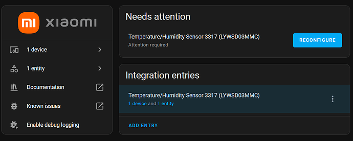

Hello, I am one week new to Home Assistant, and face a challenge that I would like to ask some help for. Excuse me if it is a trivial question, and point me in the right direction for more learning in that case :slight_smile: I have a few Xiaomi temperature and humidity sensors, and I would like to use them with HomeAssistant (installed on Raspberry Pi 3B) to monitor temperature in my house. I am having difficulty connecting them. I start with one sensor.
  1. HomeAssistant automatically detects the sensor (impressive UX!), and offers to connect to it.
  2. It asks for a bindkey.
  3. I use the tool at Telink Flasher v7.1 to connect to that sensor, and it works fine (shows the same values as on Xiaomi sensor LCD display). It also gives me a 32-character Mi Bind Key.
  4. When I use that key as the bindkey in HA, it tells me “The provided bindkey did not work, sensor data could not be decrypted. Please check it and try again.”

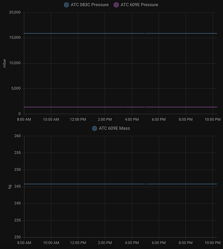

Thanks Ben, this was a saver. After some more struggle with “standard” protocol, I followed your advice and switched to BTHome, as explained at https://bthome.io/ on the main page. Both devices have been working fine since that moment. The only funny observation I have is that one of them shows, in addition to temp and humidity, mass and both show pressure (?!??!). Not sure how to interpret those yet :slight_smile:

Weird. I have several dozen that I’ve slowly collected and none of them have had those sensors.
