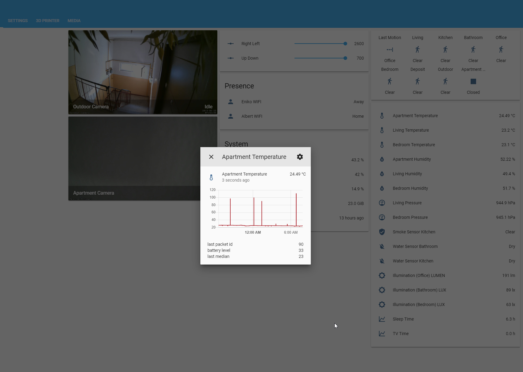

Thanks for the custom component ! Seems to work constantly but im having some spikes… any ideas how to fix ?
