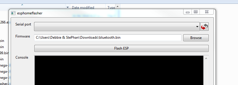

I used espflasher.exe the tick i found was
start the Flashing it and then I press the boot buttom or was it the other one can’t remeber
and them PRAYED
hope this helps

first time i had to use esphomeflasher.exe
think there a new one out .
This one has not let me down yet

step I do
write the Yaml file (do the wizard thing)
and It OFFLINE
click the … on the side
and compile it and PRAY
click the “DOWNLOAD BINARY”
it will download the bin file and save it to your download folder
NOW open the esphomeflasher.exe click browse
drill down to your download folder and select that bin file
click the Flash ESP
then press the Boot button or is the other one can’t remember and do the Praying thing again
if still red then I the ESP32dev is not sending out a message Im over here.

Thanks again mate. Yes I understand all what you have put and this is exactly what I have already done except I could not get it to flash with ESPEasy, instead I had to use NodeMCU Flasher.
I will download and try esphomeflasher and try with that. I had downloaed the Binary file and flashed however what I am interested in, is the STATE of the ESP32 Board???

Hey @myle StePhan
Good news mate. I now have two ESP32s and 2 Xiaomi Bluetooth temp and Humidy sensors working perfectly.
The code was right that I was using in ESPHome it turned out to simply be the Flashing program
I downloaded ESPHOME Flasher for MAC as recommended and perfect flashing process both times.

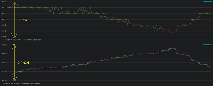

UPD. Apparently, limiting the minimum and maximum does not help from spikes in some sensors. To solve the problem, added the calculation of the median instead of the mean:
CONF_MITEMPBT_USE_MEDIAN = False # use median as sensor output instead of mean (helps with "spiky" sensors).
# please note that both the median and the average in any case are present as the sensor state attributes.
(By default, I decided to leave this option disabled, since when it is turned on, some of the advantages that averaging of measurements gives are lost. However, the owners of “spiky” sensors have no other choice but to turn the median on…)
For those who are interested, I give a comparison of the median (green curves) and the mean on a three-hour graph of temperature and humidity (at about 20 sensor readings per minute):
