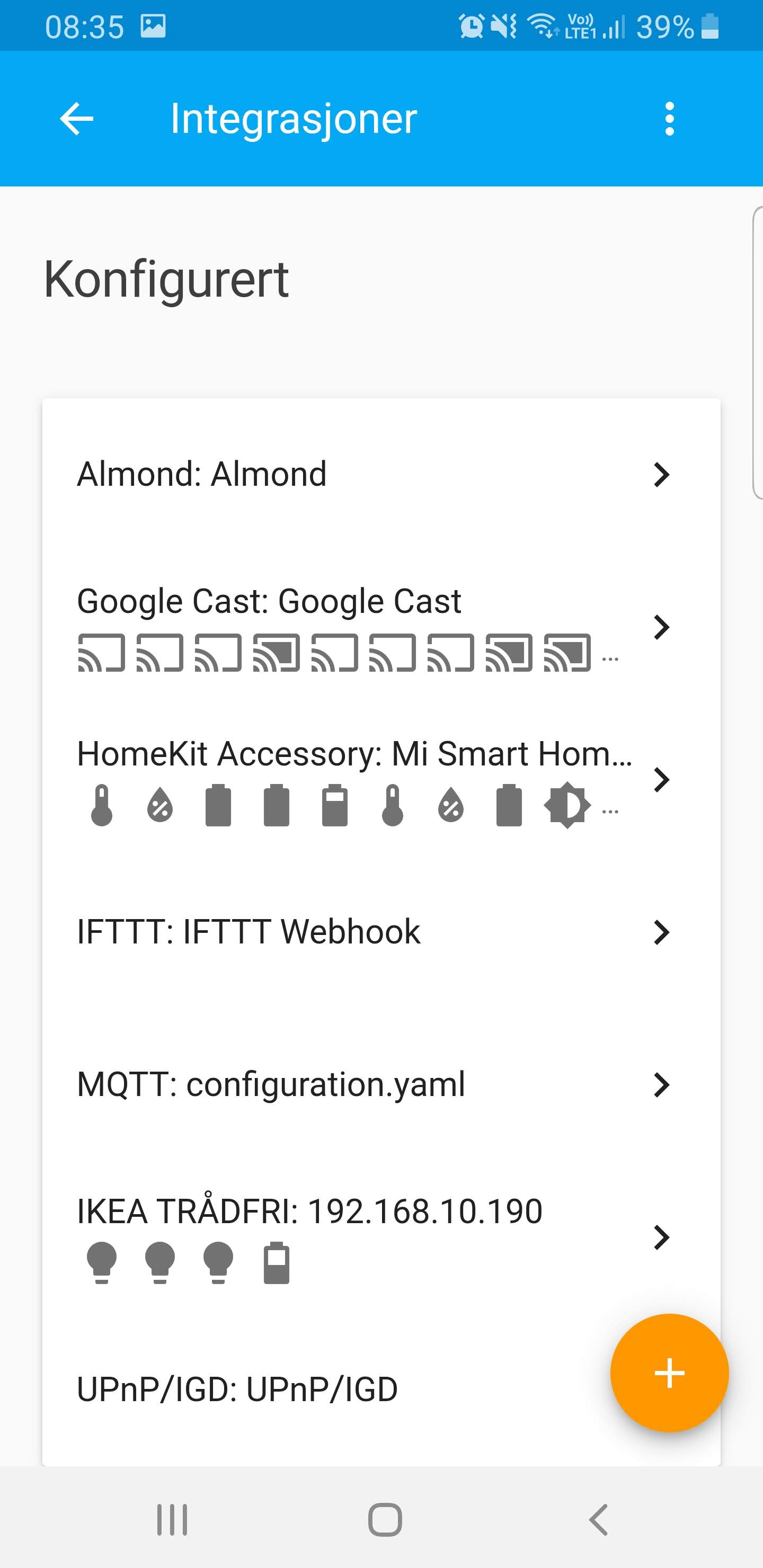

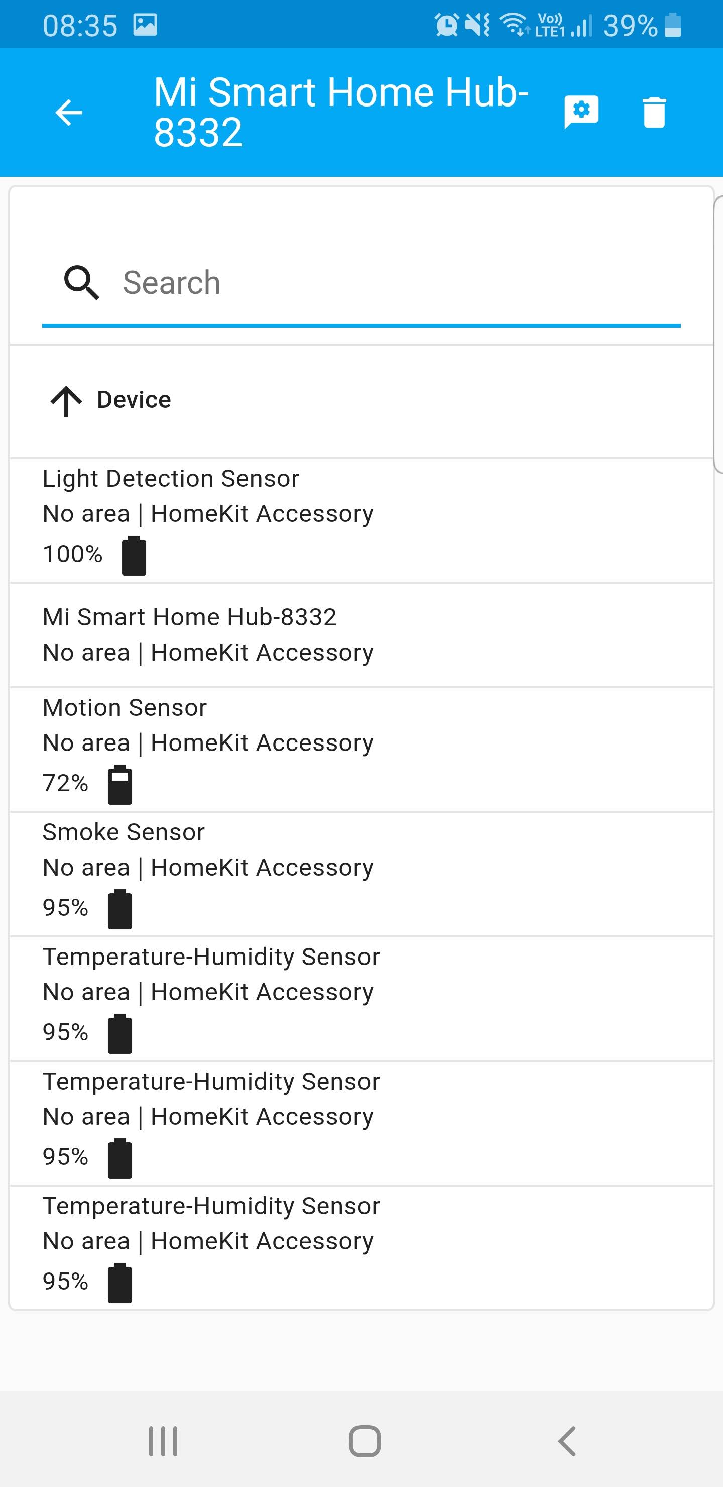

Here are some screenshots (from my mobile app).
I also would like to share some immediate experiance with the new gateway and integration in hassio. First of all, hassio did not update new devices added to the gateway after the integration to hassio was done. After integrating the new gateway to hassio (via homekit accessories integration) for the first time, I added some thermometers to the new gateway in the Mi home app. These thermometers was not discovered by hassio (tried to restart hassio but this did not help either). To add these thermometers to hassio, I had to remove the gateway from the Mi home app and re-add it. Hassio then discovered the gateway again (suggesting a new integration - homekit accesories) and after integration again, the thermometers was discovered by hassio as well.
I have successfully added the new light sensor, movement detectors and thermometers (both the sircular and square version) to hassio via the new gateway. All alongside other xiaomi devices added an older gateway.
As for the thermometers there are some peculiar findings in hassio when integrated via the new gateway. For the square versions, the air pressure does not seem to be supported in hassio, although it it supported in the xiaomi home app. And the temperature shown for the square versions are without decimal (e.g. 21 degrees and not 21,4 degrees). For the circular version, the temperature is given in hassio with decimal. The same difference applies for the humidity.
After adding the new gateway to the Mi home app, my hassio discovered a new integration (“Homekit accessory: Mi Smart Home 8332”). When I clicked on the new integration I was told to enter the homekit code as printed inside the box that the new gateway was packed in. After doing that, the gateway successfully was integrated to hassio. I do not have the homekit app (nor Homekit speakers) and uses android.
To be able to discover new devices connected to the gateway in hassio, I have removed (from the Mi home app) and reintegrated the gateway a few times. Sometimes after readding the gateway to Mi home app, hassio does not alway discover the gateway as a new integration. Sometimes I have to repeat the procedure a few times to succed (and also restart hassio). It sometimes also takes a few minutes for hassio to discover the new integration (gateway). If hassio does not automatically discover the gateway as a new integration, I am not able to add it manually by adding a new homkit accessory integration (hassio only discovers Ikea as a homekit acccesory, no Xiaomi gateway).
