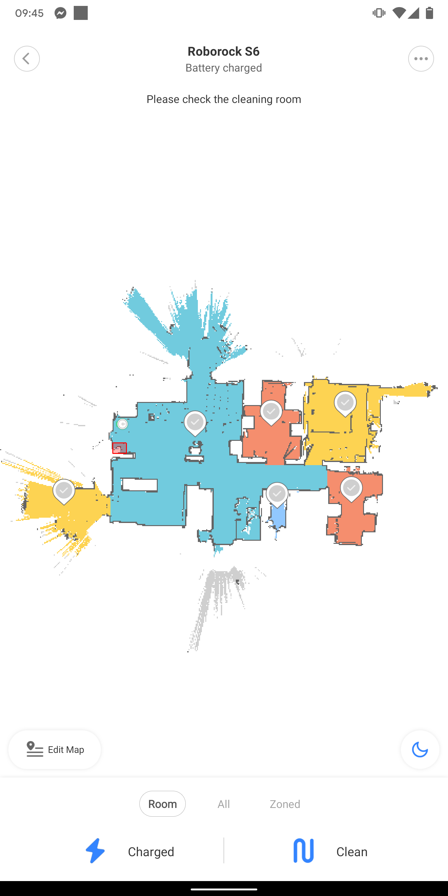

Now I just need to figure out why I only can find 2 rooms with the miio command. 18 and 19 is the ones but should be 2 more.
Pls show me a screenshot from your mihome app.
Oh, okay, i don’t have an S6.
Maybe try and error could help.
Test 18 and 19. If they work, try 16,17,20,21 and so on.
My numbers are: 16,17,18,19,20,21,22
Robo did redraw the map and then I have all my rooms from number 1 and forward
